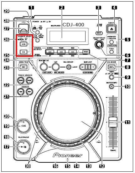

Did you press SOURCE SELECT button and selected the source PC?
The manual says:
SOURCE SELECT buttons
- USB select button
Select when playing files from a connected USB memory device. Each time the button is pressed, the function alternates between USB and PC.
- CD select button
Select when playing CDs or files on a CD-ROM.
The manual says:
- USB select button
- CD select button
Posted Fri 17 Apr 09 @ 8:53 am
Yes... thats how i connected the 2 vdj
Posted Fri 17 Apr 09 @ 8:55 am
Probably you misundertood. I am not talking about the connection between computer and CDJ but rather the turning on of the reading of the files you have on your computer by pressing the SOURCE SELECT button.
Posted Fri 17 Apr 09 @ 9:02 am
