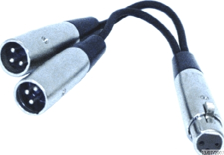

No mate. That is not what I am saying at all. On the back of your amp you should have input and link connectors for each channel. The output from your RMX is connected to the input sockets but there should still be a pair of sockets that would normaly be used to link or daisy chain to another amplifier. Connect one of these to your sub.
You mention that your amp is a Crest 1800. There are several 1800 amps made by Crest, so if you can post the full model number I can tell you exactly which connection to use.
If your amp is not equipped with input link connectors you can use one of these on one channel to provide a feed down to your sub.
Connect the female XLR to the cable coming from one channel of your RMX. Then one male XLR to the amp and the other to the sub.
