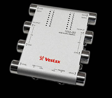

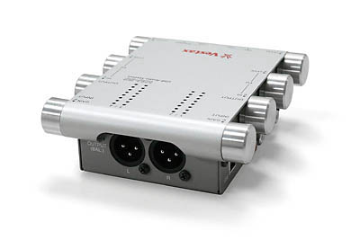

Features:
> 4 in RCA
> 4 out with RCA and XLR connections with 2 band EQ and level control
> Headphone out with level control
> MIC in with level control
> Signals are send through an analog EQ circuitry, adjusting level, quality and pressure of the sound.
> Direct connection from computers to PA is enabled with the wide head room for XLR's.
What do you think of the looks....SICK isn't it?
> 4 in RCA

Please check on the pictures, it's a USB audio interface.

Damn, those looks sexy as hell ;)
Seems vestax is making loads of cool gadgets for software djs
