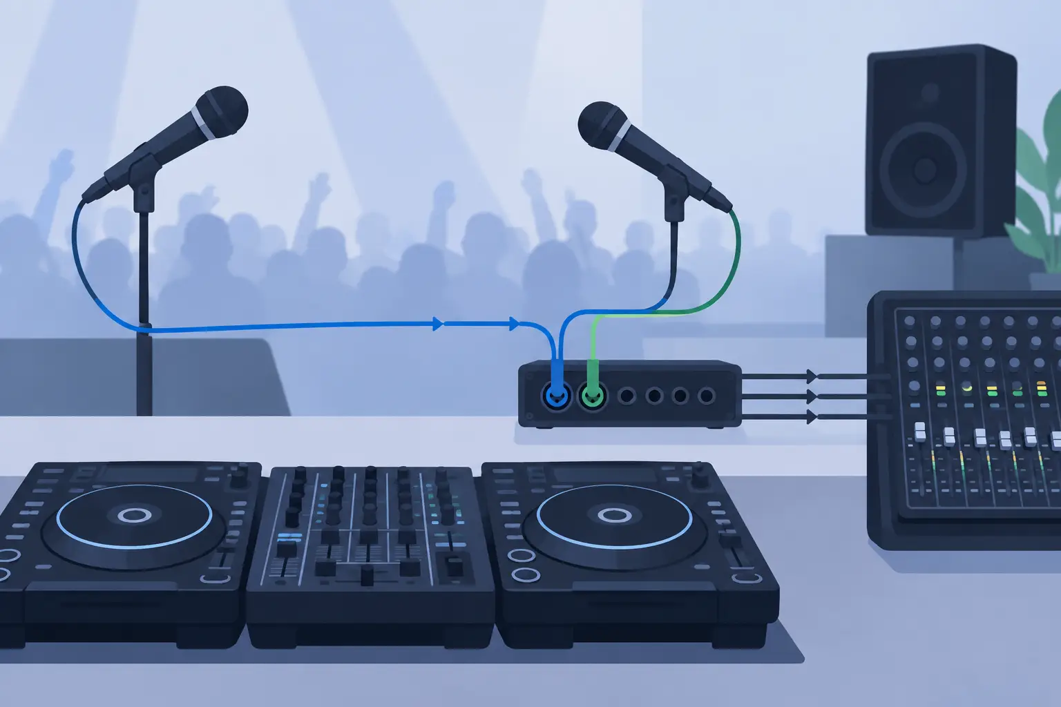

Route Through the Controller or Mixer
For most mobile DJs and club performers, plug the mic directly into the controller or DJ mixer. Turn up the mic gain, set the mic channel level, and send it to the master output. Your audience hears the voice through the same PA as the music.
This is the simplest route and usually the most dependable. It also gives you immediate access to hardware controls, so you can lower music, make an announcement, and bring the set back up without reaching for the laptop. If your mixer offers talkover or ducking, it can automatically reduce the music when you speak.
Use this approach when the room is your priority and you do not need the microphone inside the software. It is especially effective for dance floors, introductions, raffle calls, and quick transitions at weddings.
Route Into an Audio Interface or Software Input
If you need the microphone in a livestream, recording, podcast-style set, or video mix, route it into an audio interface or a supported microphone input that your computer can access. Then select that input in your DJ or broadcast application.
This route gives you more creative control. You can apply EQ, compression, effects, noise reduction, or separate level management. It also makes it possible to record the mic alongside the music, rather than recording only the master output.
The trade-off is latency and complexity. A mic monitored through software can feel delayed in headphones or speakers if the buffer is too high. Keep latency low, use a stable audio driver, and avoid stacking unnecessary processing when you need to speak live.
Use a Separate Mixer for Larger Events
At a larger event, the DJ controller does not always need to be the center of the microphone system. A separate live sound mixer can receive the DJ master output, wireless microphones, ceremony microphones, and additional performers, then send a polished mix to the venue PA.
This is the professional move when multiple microphones are involved. It lets you control every source independently and gives you a dedicated soundcheck workflow. For example, a wedding DJ can send music from the controller to channels 1-2 of a mixer, put the officiant's wireless mic on channel 3, the handheld toast mic on channel 4, and send a separate feed to a camera or stream.
You give up a little speed at the DJ booth, but gain far more control. For ceremony, corporate, and karaoke work, that control is worth it.
