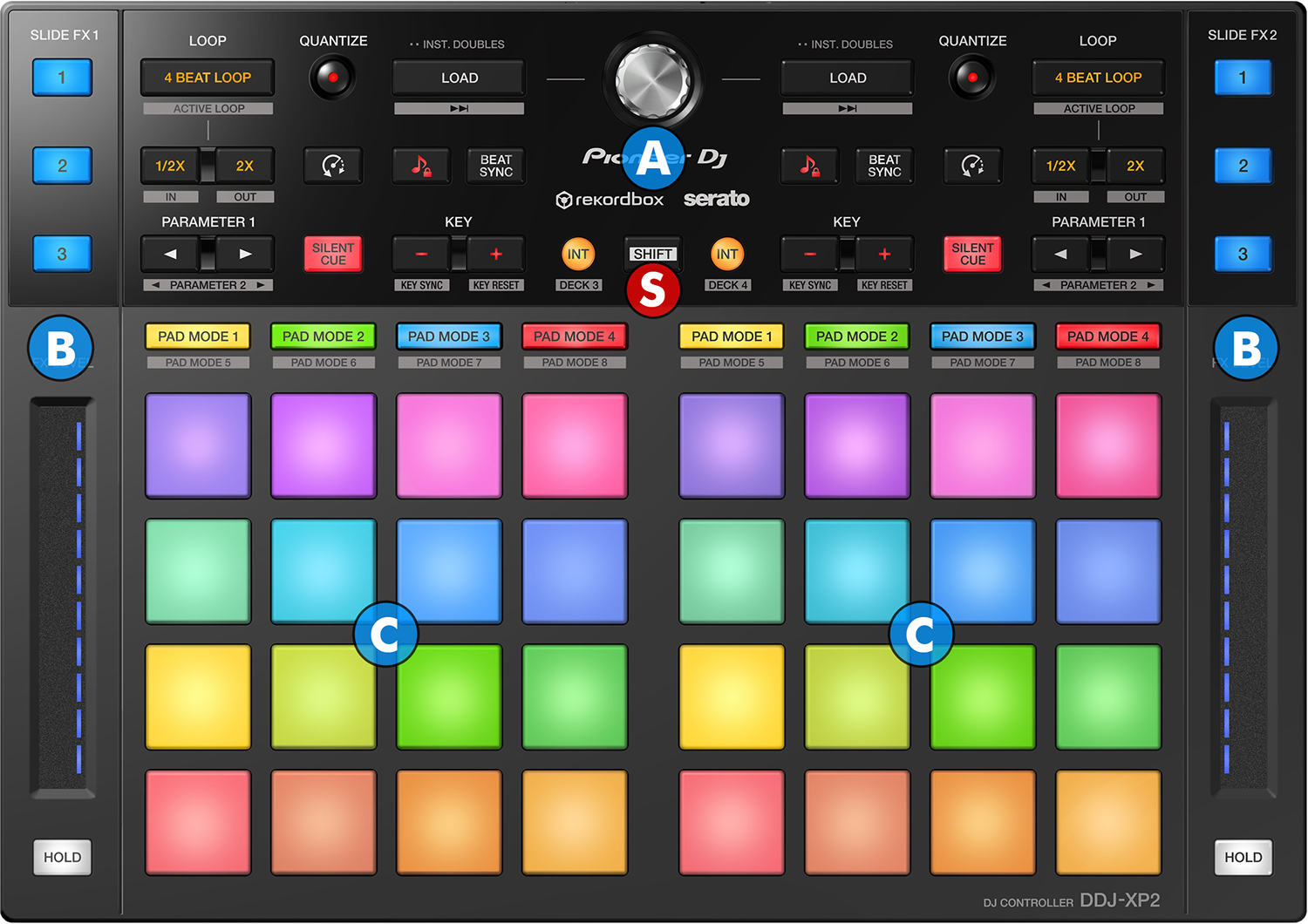

Hello, I was wondering if it’s possible to configure this type of effect on my DDJ-XP2.
Specifically, I’d like the effect to apply to all stems except the vocals, which VirtualDJ should recognize as MeloRhythm.
Since I always use my DDJ-XP2 when performing, I’d also like to set up the effect slider as shown in this picture.
Any idea?
Thanks.
Any idea?
Thanks.

1. Download "Filter HP" (and "Filter LP") effect(s) from Addons
2. Load them as an effect on one slot (e.g. effect slot 3)
3. Toggle Effect Stems on
4. Use the stripe on your controller as per the instructions on the manual
Posted Tue 09 Sep 25 @ 6:46 am

Thanks tomorrow I will test it.
When you say Toggle Effect Stems on, I suppose there's a native option within the addon itself.
Let you know!

No there's not an option on the effect itself.
All the effects can be applied on specific stems.
https://virtualdj.com/manuals/virtualdj/interface/decks/decksadvanced/effects.html#stemsfx
Posted Tue 09 Sep 25 @ 7:25 am

IT WORKS thanks!!!!
Posted Wed 10 Sep 25 @ 2:40 pm
