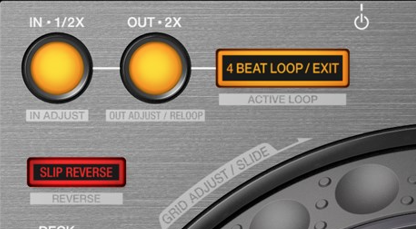

So, the DDJ-1000 (a Rekordbox oriented controller) has IN-1/2X and OUT-2X printed on the buttons:

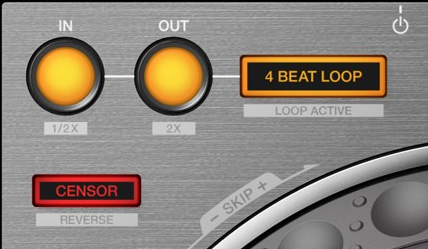

On the other hand, DDJ-1000SRT (Serato Oriented) has only IN and OUT printed on the buttons:
To make matters worse, look what's printed under the buttons in reverse gray box.. That's the SHIFT+ operations.
For DDJ-1000, SHIFTed operations are loop adjust.
For DDJ-1000SRT, SHIFTed operations are loop half/double
Pretty much that's the reason the mappings are different.
