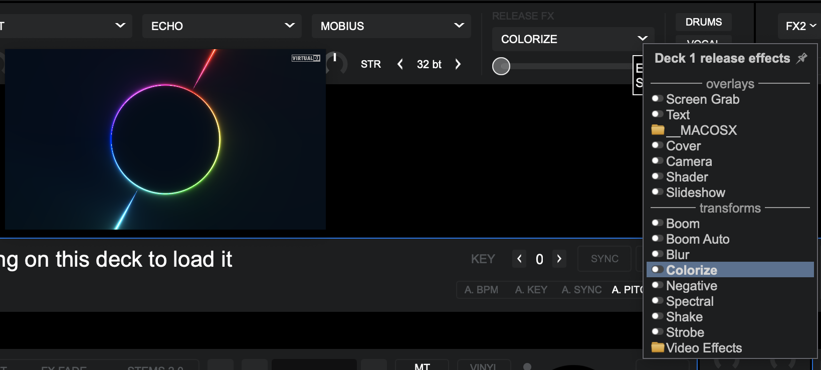

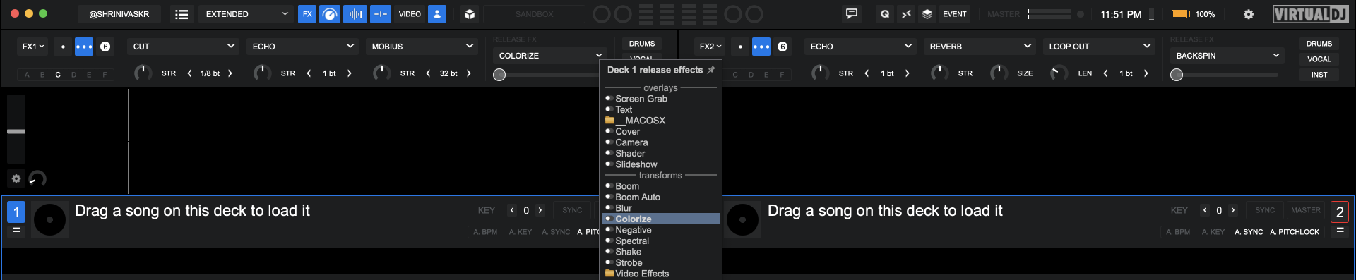

I'm a bit confused on how to use the 'ReleaseFX' functionality on VirtualDJ. When I click the options in that slot, it appears to be opening a video panel. I'm not trying to do anything video related.

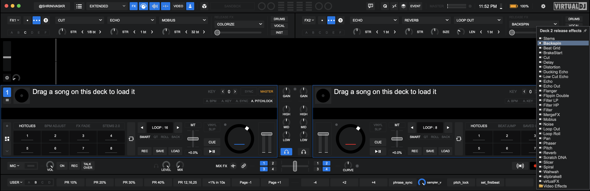

Hmm, looked again at it, but this seems strange to me, but maybe one of y'all might know better.
The options showing up under releasefx for deck 1 are different than the options under releasefx for deck 2.

You need to go back on the tree and select the audio FXs. Your deck 1 is showing video FXs.
