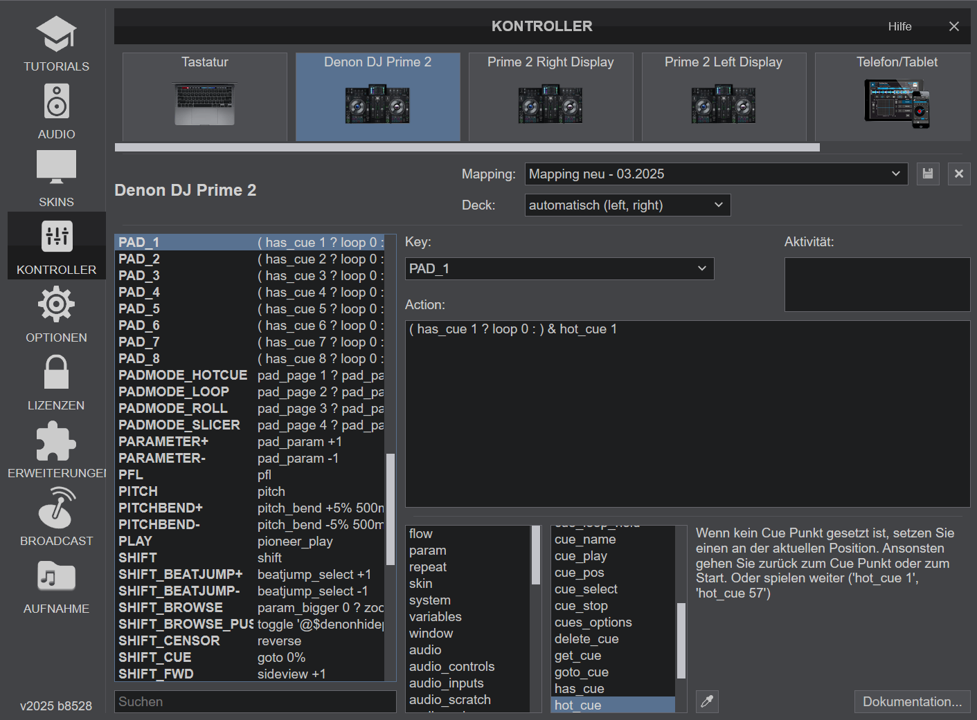

what i want to achieve is, that i want to be able to exit an active loop automatically, in the moment i press any Hot Cue Button. Even if the Hot Cue button is set in a song position before (!) or inside (!) the active loop.
(Without having to press the loop out button on the controller manually)
I was playing around with some controller mapping commands, in the LOOPOUT option, but didn't manage to get it working, as i wanted it to.
Do you know, how i can get that fixed?
Posted Sun 23 Mar 25 @ 5:03 pm
( has_cue X ? loop 0 : ) & hot_cue X
remap your pad page like this.
Posted Sun 23 Mar 25 @ 5:39 pm
You are the BEST!
This works.
But i have another (new) problems:
If i press a pad from the saved loop bank, the loop is not beeing activated / marked. It just behaves like when i press a pad from the normal Hot Cue bank (jumps to song position).
And:
I am not able to delete and / or save a loop anymore. And can not delete a hot cue anymore, too (but i am able to save a new one).
Do you know a solution for that?
This works.
And:
Posted Fri 28 Mar 25 @ 10:46 am

I have mapped the "PAD_1" until "PAD_8", by changing the "X" to "1" in "PAD_1", to "2" in "PAD_2" and so on, in the controller mapping menu.
That was everything i have done so far.
Posted Sun 30 Mar 25 @ 4:59 am
That's definitely not the right way, because you will not get the Pads working properly in the other Pad modes.
You should leave the pad 1, pad 2 etc actions as they were in the device Mapping, and change the actions of the Hotcues Pad page from the Pads Editor
Pads : https://www.virtualdj.com/manuals/virtualdj/interface/decks/decksadvanced/pads.html
Pads Editor : https://www.virtualdj.com/manuals/virtualdj/editors/padseditor.html
Posted Sun 30 Mar 25 @ 5:17 am
Hi DJDAD,
you are absolutely right - made no sense how i did it.
I have changed the commands in the Pads Editor now (had to search like forever, how to access the Pads Editor, lol) - now it works perfectly!
I am very thankful for this cool and helpful VDJ community!
Will definitely stick to VirtualDJ.
Have an awesome sunday!
Posted Sun 30 Mar 25 @ 5:41 am
