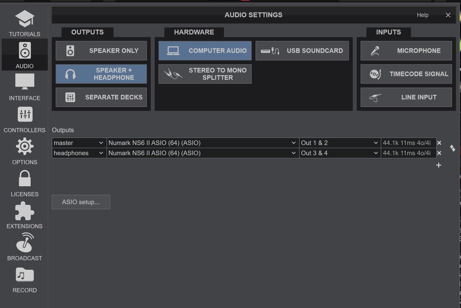

There are my audio settings. Using the Numark NS6II

PitchQuality is at 4
ASIO driver buffer size is set to 256
Latency in VDJ set to 256 (to match driver settings of Numark NS6II ASIO)
UltraLatency is set to Yes
SampleRate is 44100

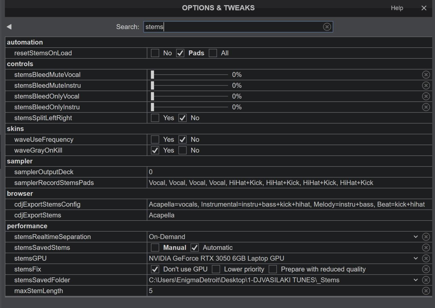

Below are stems settings

Happened again with pitch at 3 and ultralatency on. Turned that off and will test again. Any other ideas? Could it be the stems?

Thanks very much. I cannot reproduce without the controller connected. I disabled stems completely and it didnt happen this weekend at a wedding but not sure if I just got lucky. Weird because my new PC was purchased and spec'd out to specifically run stems. Will check your other recommendation out - I am running W11 Home so I'll check how to enable high performance.

Thanks, I ended up writing a powershell script to do it and following some other tweaks and my latencymon results look quite better. The CPU still skyrockets when using stems so not sure if there's anything that can be done there, but I'll keep messing with it before my next gig. Thanks for the help!

Stems should use the GPU if it's capable, if not disable them. Check settings.
