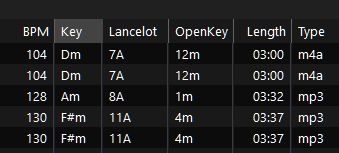

Due to this I created two other columns in Mp3Tag named "Lancelot" and "OpenKey". These colums use the original tag "initialkey" as input and just replace the content. The definition in Mp3Tag for the customized new columns is simple:
In the brackets of the replace command (...) all 24 relations of the notation systems have to be inserted pairwise.
Here is a screenshot from Mp3Tag:
I like to read such information also in other tools like Musicbee. In this case another method in Mp3tag is required to store this in files and no formula in the field itself can to be used. A separate action script is required to fill the customized fields.
Value: $replace(%initialkey%,Dm,12m,F#m,4m,Am,1m, ...)
Field: %openkey%
Value: $replace(%initialkey%,Dm,7A,F#m,11A,Am,8A, ...)
Field: %lancelot%
Posted 7 hours ago
The key conversion can be done by starting from the musical notation of "initialkey"
with so called actions with Mp3tag. After this conversion, all three key notations
are visible at least in Mp3Tag, ExifTool and MusicBee.
I described the procedure and published the actions scripts here:
https://community.mp3tag.de/t/initialkey-conversion/67610
