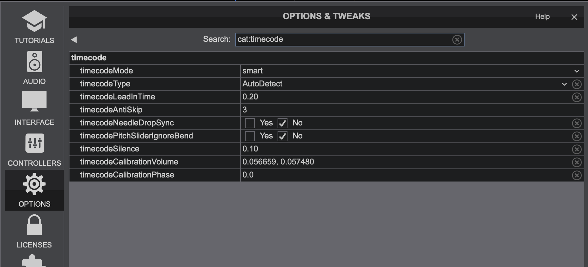

Can you check the time the lead out starts in the timecode page in options?
Posted Sat 15 Feb 25 @ 11:05 pm
I don't see a lead-out time, only a lead-in time
