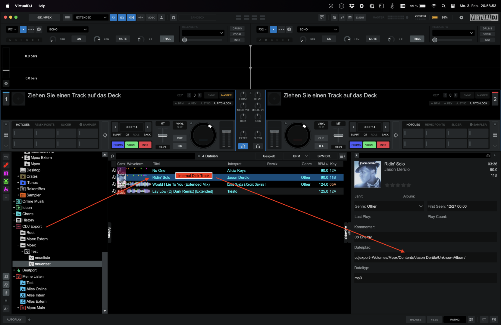

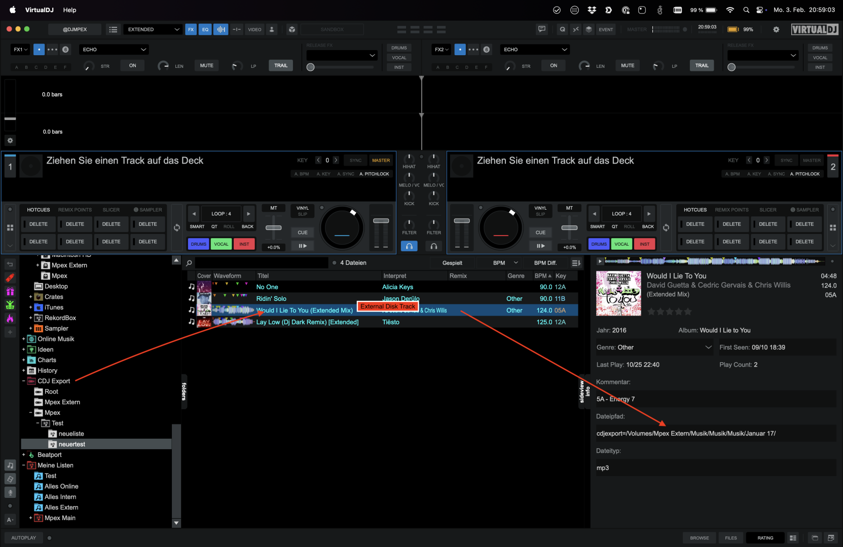

Hello,
First of all, thank you for your responses and help. I will try to provide as detailed descriptions as possible.
I am using a MacBook Pro 2021 M1 with Mac OS Sequoia 15.2. Virtual DJ is running on version v2025-m b8502.
The issue affects both Virtual Playlists that have been created and the playlists under "My Lists".
I just created a new Virtual Playlist and added two tracks:
Two tracks that are stored on the internal drive of my MacBook, which have been analyzed in Virtual DJ and are included in its database.
Two tracks that have also been analyzed in Virtual DJ and are in the database but are stored on an external hard drive, just like 95% of all my tracks.
Now, when I right-click on this playlist and select "Export" from the dropdown menu, the Export window opens as expected. I then select CDJ as the export method, choose my FAT32-formatted USB stick as the destination, and set compatibility to "CDJ-2000nexus".
One thing I also noticed is that under the "Folder" section, I cannot select anything. It is set to "(Root)" by default, even though my USB stick already contains folders.
After clicking OK, Virtual DJ shows that files are being copied to the USB stick. When I check the CDJ Export section in Virtual DJ's browser to view the playlists on the USB stick, all tracks from the playlist appear to be there.
However, when I open the "Info" window or check the Tag Editor of a track, I see that the file path for the tracks from the external hard drive still points to the external drive instead of the Content Folder on the USB stick. Only the tracks from the internal drive have the correct path pointing to the Contents folder.
When I check the USB stick via the Mac Finder, I can see that only the two tracks from the internal drive are actually in the Contents folder, while the tracks from the external drive are missing.
It seems like Virtual DJ is only writing a "link" to the track on the USB stick, making it appear as if the track is there. The tracks are even displayed on the CDJs as if they exist on the USB stick. However, when selecting one of these tracks on the CDJ, it gives the error: "NO FILE".
Here are some screenshots showing the file paths of the tracks. (It makes no difference whether this is done with a Virtual Playlist or a "My Lists" playlist; the issue is always the same.)
Thanks for your help!
