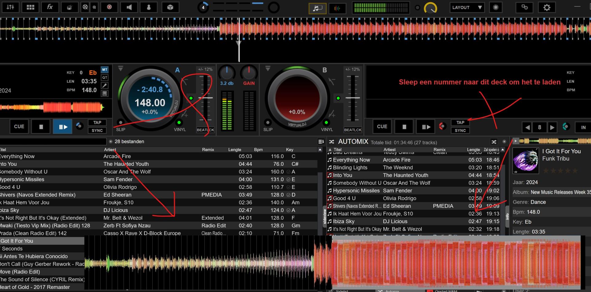

Hi All,
My intention with the question is purely to getting familiar how the code of the skin works. I really would like to make my own skins.
As an example i have this piece of script (out the blocks skin). How can i redirect my, original floating browser button, to floating this scratchwave? Or let say i have just 1 button; how can produces this in an floating window?
The SKIN SDK page is really written out good, but to make the whole picture clearer for me i just need more specific examples (or video`s even better).
Thnx!!
Gr. Marcel

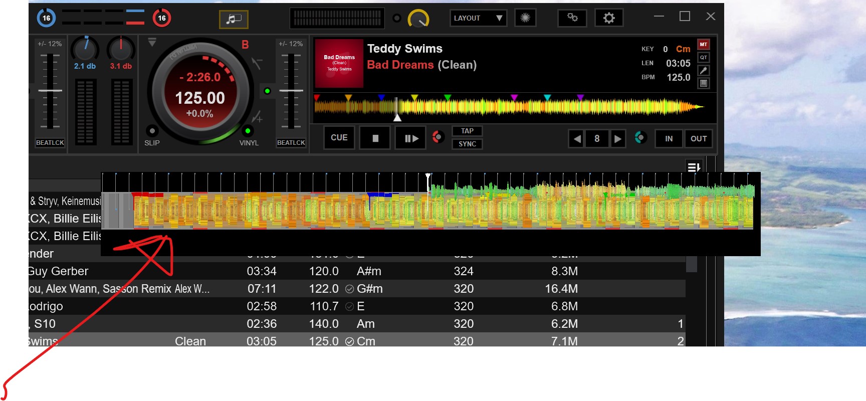

Hi locodog,
This helps me a lot!!
I substitute the codelines in the skin xml file and it works, but i have a strange effect going on.
When playing the track, the scratchwave in the floating window is becoming distorted, hitting pause it still is being displayed as a distorted wave. I have included some pictures below.

I can't see drawing 2 elements, especially moving elements, over each other being a good idea, probably better to avoid that.
Also resizing could be at issue, defined window size can matter, from the full 1920*1080 specified, squashed like you have can cause artefacts.
Define your window closer to the in use size and reposition your elements.

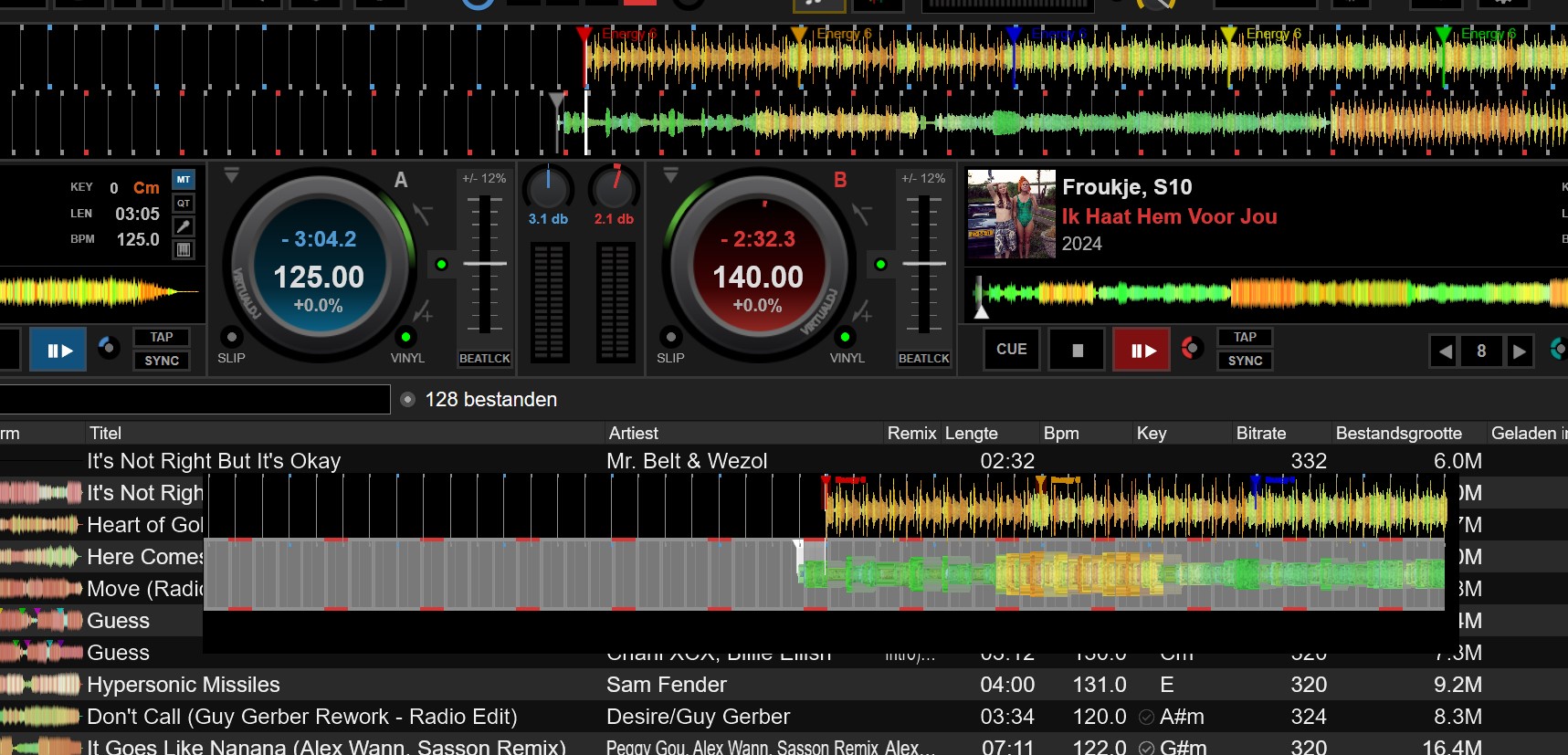

The waveforms pasted above eachother was just when fiddling some things out. No use for that.
But i have filled in resize="false" in the window and the pixel settings 1920x1080 (like the original "mother" skin).
Still the waveforms get blurred when the track is being played.

oh you need a background, draw it before your waves, fill the full canvas.
Posted Wed 13 Nov 24 @ 2:22 am

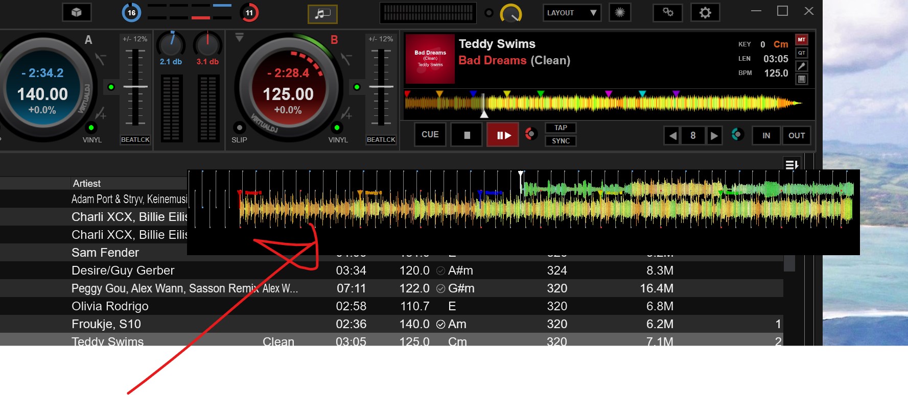

I dont know exactly what you mean. I dont need a specific background, just the black backgrond from the floating window is fine.
The grey area behind the waveform in the external window occurs when the track being played and the waveform start to distort.
Posted Wed 13 Nov 24 @ 6:07 am
You need a background, as it is it isn't a black background, it's nothing so it shows as black. because you haven't drawn over the previous frame the next frame will have transparency and will show old frames.
Just draw a <square> canvas sized before your waves.
Posted Wed 13 Nov 24 @ 6:49 am
Yes this the solution. Here you see the floating window with the left side of the canvas that has a background color and the right side not.
