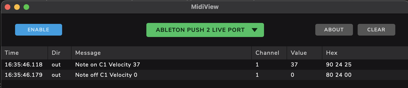

Push is recognized and the mapping is apparent in the 'Key' selection, but I get no input at all in 'Activity'. I'm on mac and use MidiView to control midi input. In MidiView Push has a Live Port and a User Port. When Buttons are pressed, midi is detected via User Port.
Now could it be that VDJ is listening to the Live Port while Midi is transmitted via User Port? How can I tell VDJ to switch ports? I've tried drivername="ABLETON PUSH 2 LIVE PORT" (as named in MidiView) but didn't work.

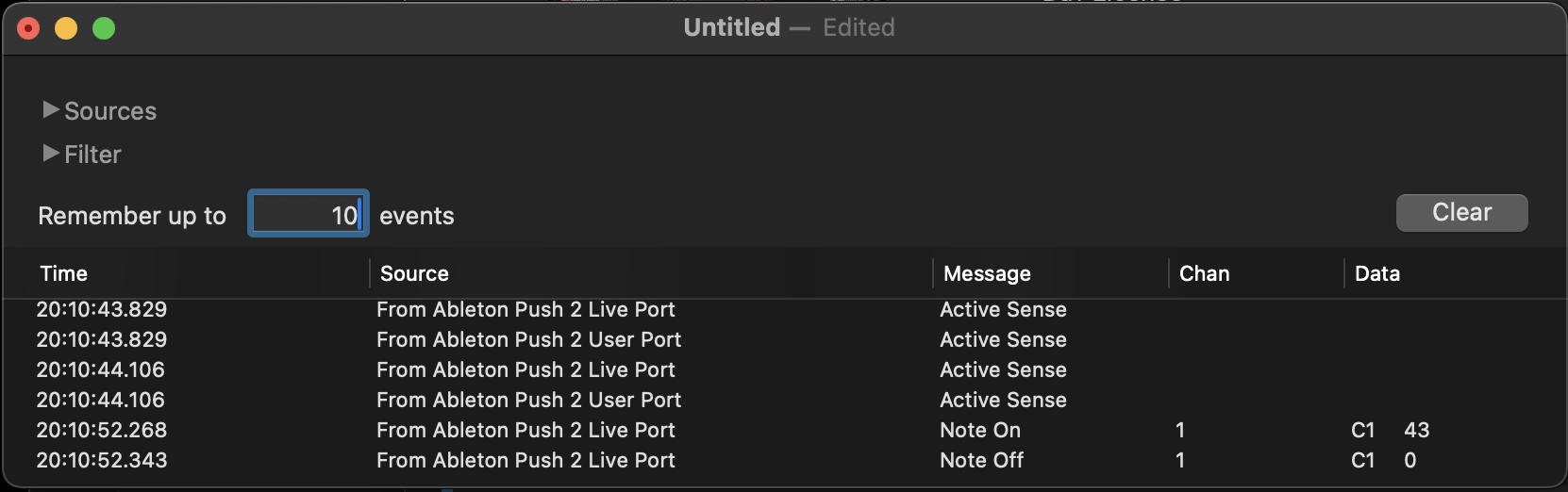

I've already tried 24 instead of 36, also cc instad of note in every combination, to no avail.
Midi Monitor shows a permanent flow of "Active Sense"-Messages. I've filtered them out for the screenshot:
Here's what MidiView is showing after the same button press:

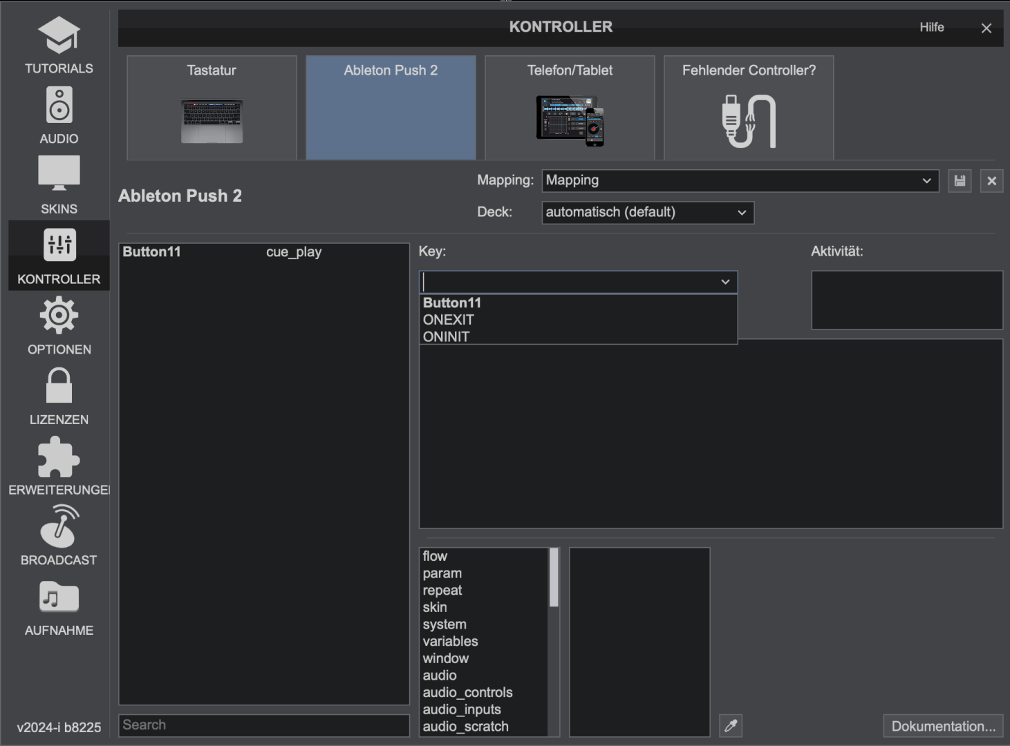

And here's the devices and mapping:

As for your Button definition, it should be ..
You get 90 24 xx in your Midiview pic.
9 means MIDI note, 0 means channel 0 (1st available) , 24 (in hex) is the Note, xx is whatever velocity value the button sends and gets interpreted as pressed or not.
<button note="0x24" name="Button11" deck="1" channel="0" />
