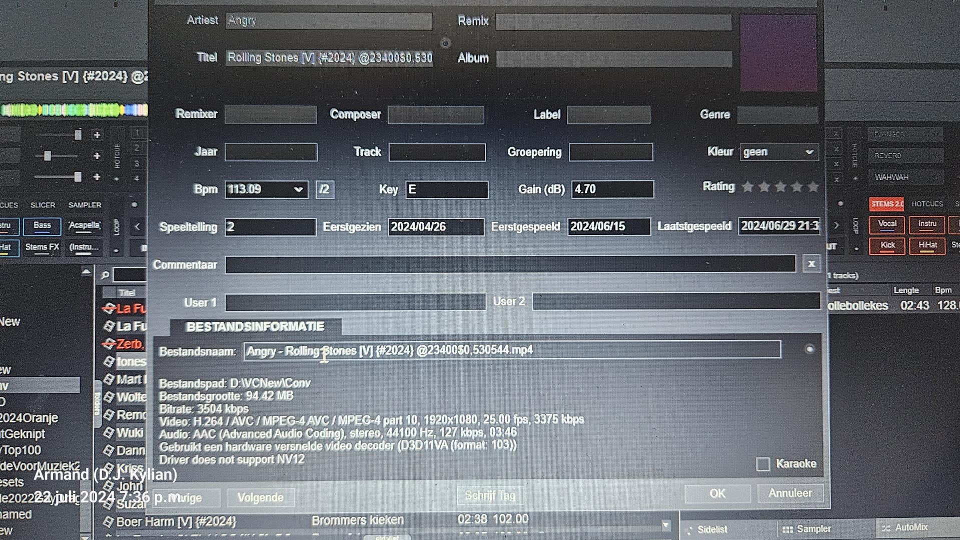

No issue with 1080 interlaced video here.
Can you post a screenshot of the issue, as well as the tag editor info section of an affected video?

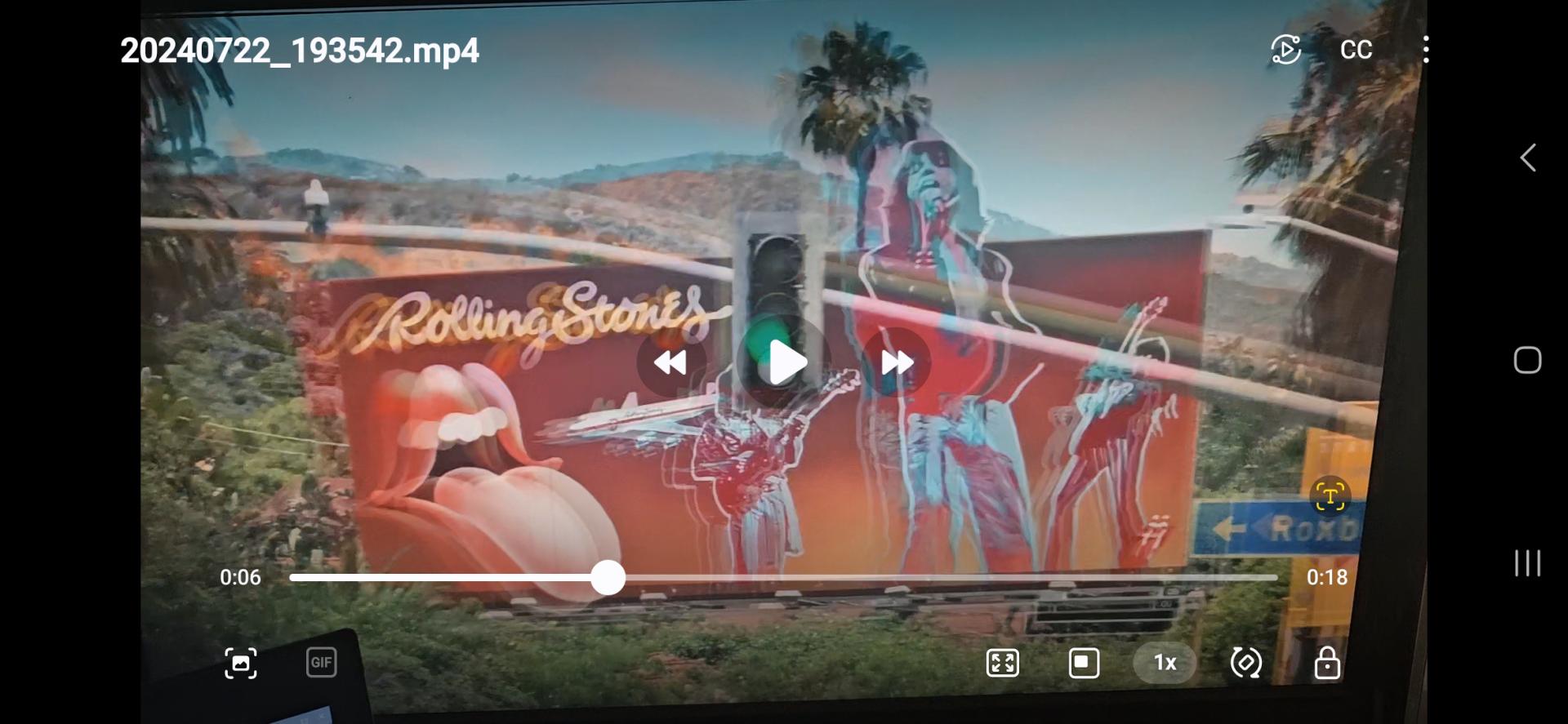

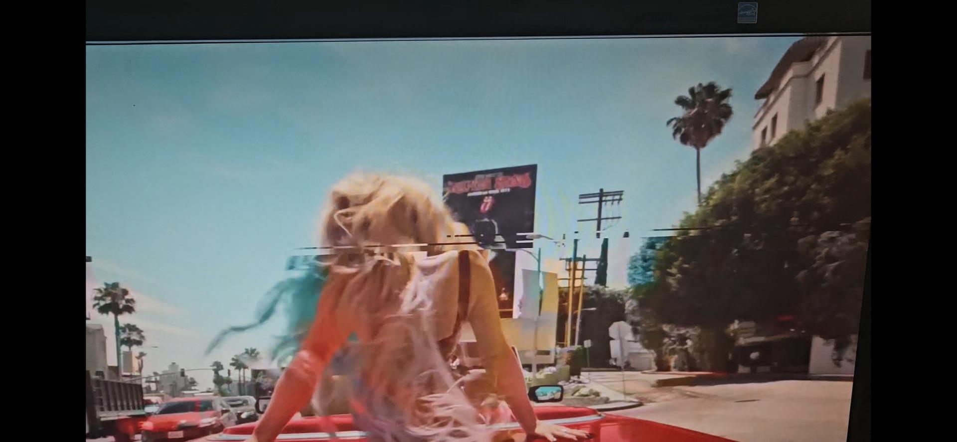

Here is the file info. I recorded a short video of the glitches with the 8184 version. The same video is playing without glitches in the 8095 version.
If needed i can upload the video to my website.
Posted Mon 22 Jul 24 @ 5:47 pm
Image one
Posted Mon 22 Jul 24 @ 5:57 pm
Image two
