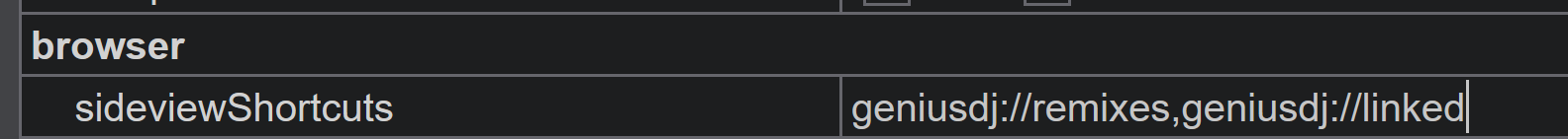

can be done currently.. so to add tabs for "Alternative remixes" and "Linked tracks"
edit the option sideviewShortcuts to include, as shown:

As IIDEEJAYII, you could manually add them by changing the sideviewShortcuts option
All possibilities from the remixes tab:
geniusdj:\livefeedback
geniusdj:\similarsongs
geniusdj:\remixes
geniusdj:\linked
geniusdj:\remixes
geniusdj:\linked
