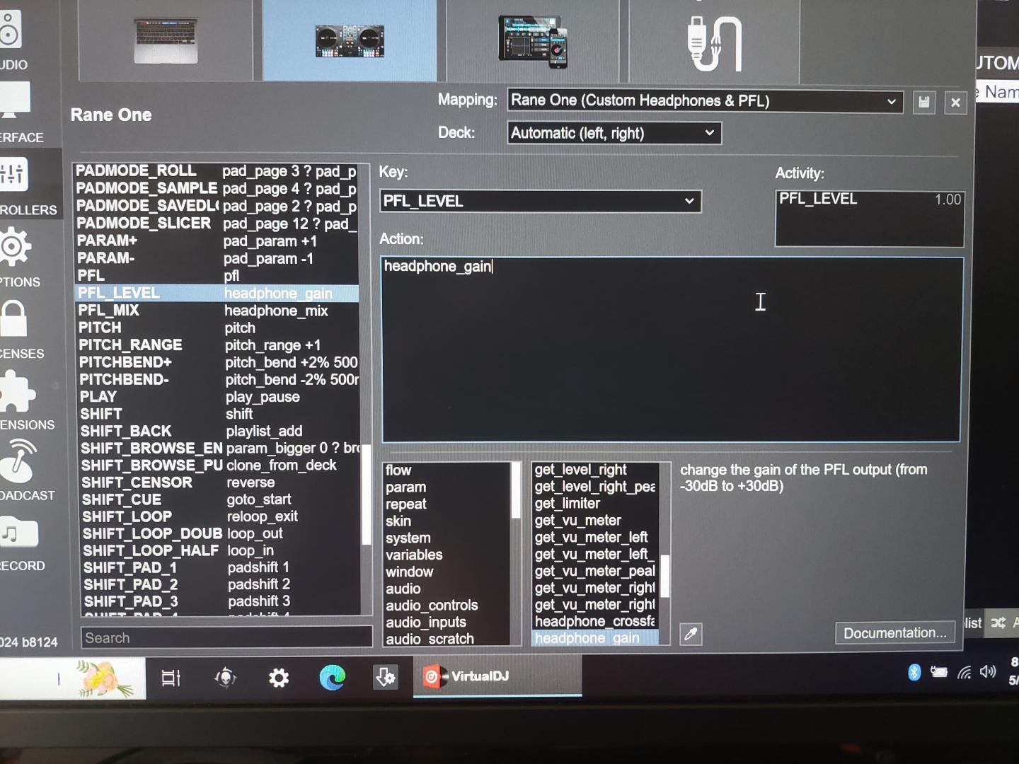

I'm trying to raise my default headphone volume up.i did a google search and found a post that said go into mapping, select PFL_LEVEL and in the Action Box change the headphone_gain
my question is what do i change it to ? right now when i turn the headphone volume knob all the way up it shows in the Activity box PFL_LEVEL 1.00 but i can't edit anything in that box ? please help thanks

I will attempt to answer.. (not having a controller w midi enabled headphone volume adjust)
Question :
After you have changed the mapping of PFL_LEVEL from headphone_volume to headphone_gain
Does the "Cue Volume" knob on the front of the Rane One now change the volume in a range as you like ?
Since you have access to headphone_volume from the skin (master tab), you have access to both volume and gain for the headphone.
An alternative is to try the opposite method.
Keep the default mapping for PFL_LEVEL as headphone_volume
and create a custom button (slider) with script: headphone_gain
and use this additional software slider to tweak the headphone output for more gain.
Once the headphone_gain is determined, so that the "Cue Volume" knob on the front of the Rane One, gives you the range you desire, one can delete the above slider, and add its value to an ONINT script as in:
headphone_gain 85%

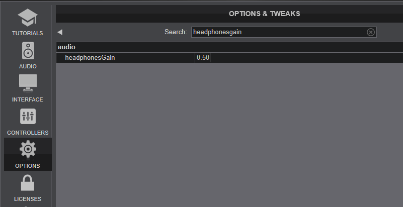

pretty sure there a headphone gain setting in options
Posted Sun 12 May 24 @ 10:26 pm
there is and I changed it to 0.80 didn't notice any difference.. closed out vdj opened back up and its set back to 0.50 did this a few tymes and it always defaults back to 0.50 ?

In the mapping for the unit has "fake_master on & fake_pfl on & fake_hp on & fake_hpmix on" as part of the oninit slot.
That usually indicates that the volume control, including for the headphones, are done directly in the hardware, meaning outside of VDJ. The script is basically telling VDJ to show the changes done on the hardware, but not adjust the audio (because it's already being done by the hardware)
That also usually means that VDJ has no way of controlling the volume / headphone volume, including adding more gain to the headphones
The firmware in the controller may have an option for it, though, and there may be a manual or utility software for that. So that may be something to look into

Try this..
- remove the .. fake_hp on action from the ONINIT key of your Mapping.
- Put the headphone_volume action back to the Rane One PFL_LEVEL Key (instead of the _gain one)
- set the HeadphonesGain setting in VirtualDJ to something like 0.8
- restart VirtualDJ
