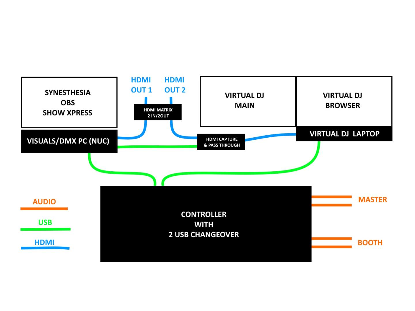

DJ VinylTouch:
This is my portable setup. The second PC is connected to the controller so it can access the audio directly for triggering visuals and DMX. The PC is not part of the main audio path.
However, I do have redundancy for VDJ if the laptop crashes, as I can just switch from A to B USB on the controller.

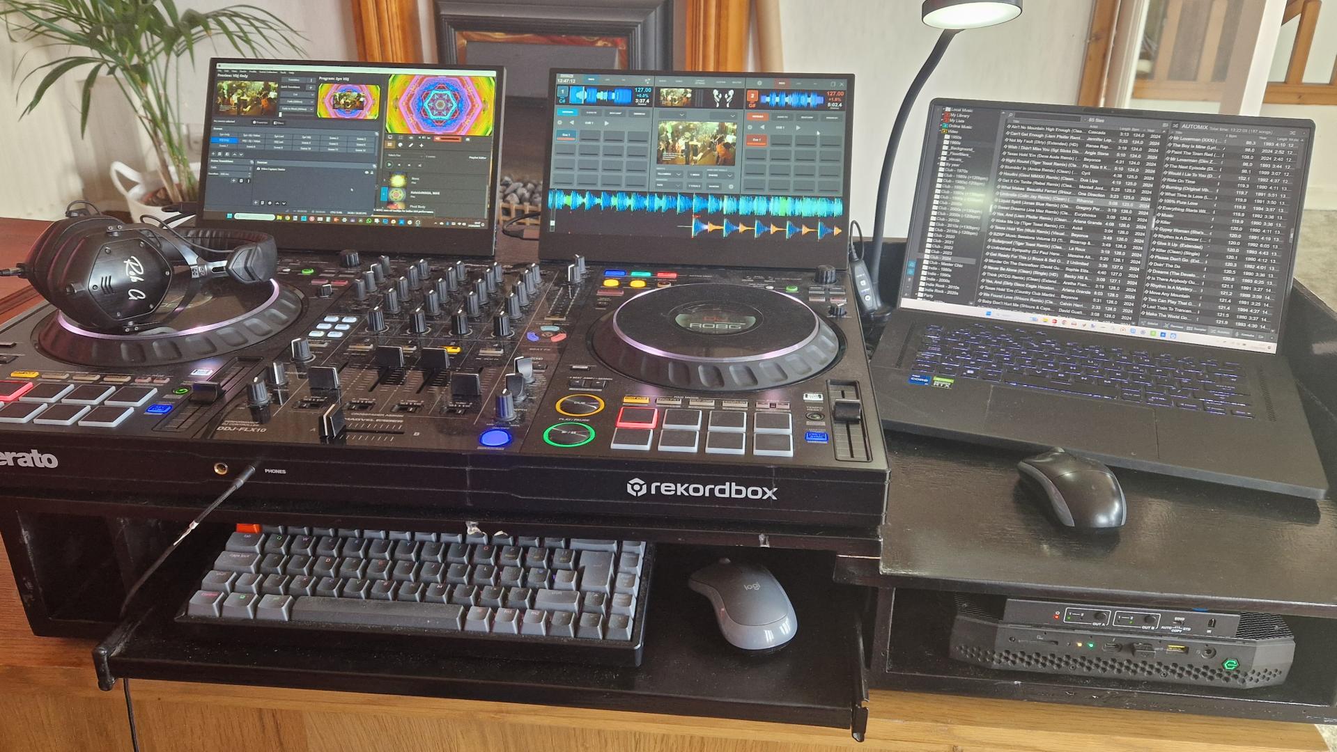

My setup in the flesh..
Posted Sat 27 Apr 24 @ 11:57 am

GroovinDJ: for my setup at home the audio delay was 230ms, with Synesthesia delayed in OBS for 70ms to match the videocapture from VDJ.
I will have to adjust the main audio output delay some more when I setup at the venues with each being slightly different, but that's easily done with 1 slider.
PhantomDeejay:
I couldn't use virtual cable/software because the master out has the same output as booth. I think its a flx10 driver thing.
I also extract the audio directly from the flx10 as the second pc is also connected to controller.
I do use a direct ethernet cable between the two forthe OS2L timing forDMX though.
PhantomDeejay:
