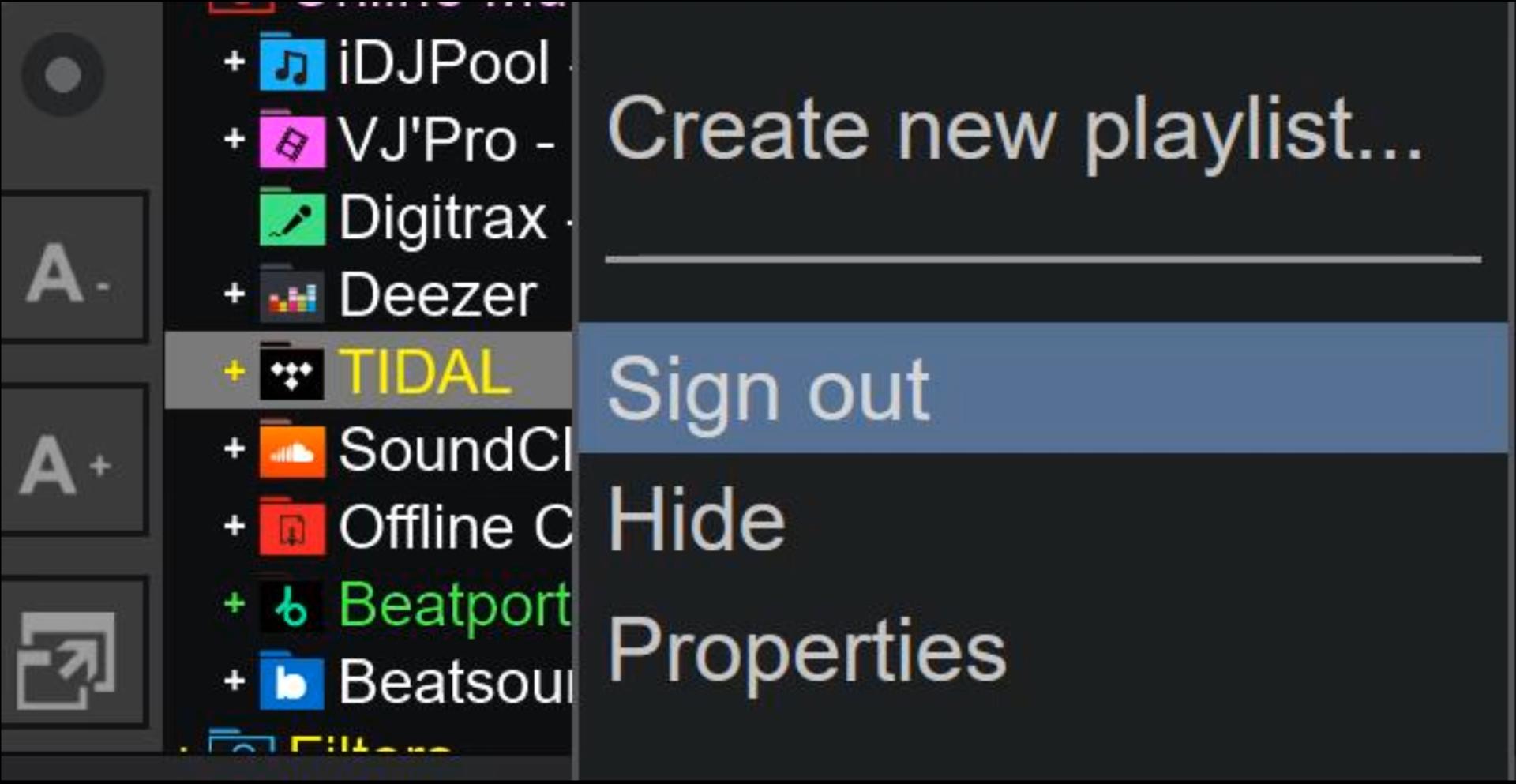

Right Click Tidal to get menu options

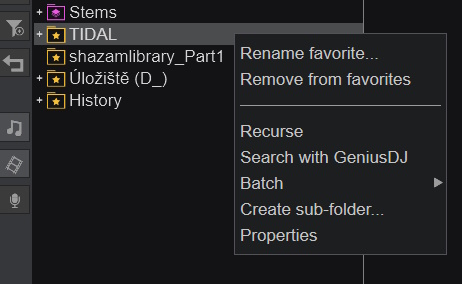

Thank you. The mistake was that I first right-clicked on the created shortcut among favorites, the option to log out is not offered here (I usually have the Tidal root folder hidden).

OR maybe I do not understand the issue, creating a shortcut does not hide. (2 different steps)
Tidal is located as a subfolder of Online Music if you have NOT hidden it.
either way.. once you locate Tidal you can log off with the R-click menu.
