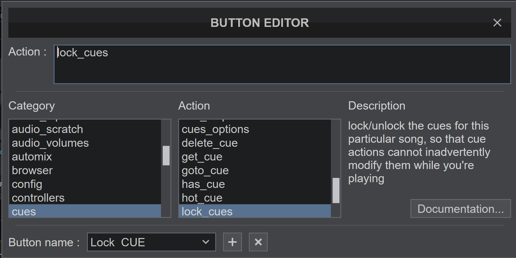

lock_cues is a script use it anywhere a custom button works well and is visual when locked

user27661736 wrote :
How do I lock/unlock my cue points?
Locodog already mentioned how to do that:
and it would look like, this in a custom button:
one should be created for each deck, and will be highlighted when the loaded track has it's cues locked.
Just click the button to unlock or lock that track's hotcues.

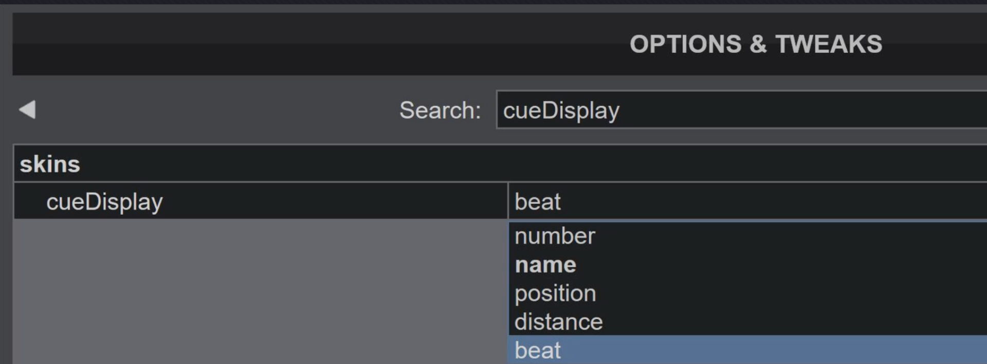

How do I change the cue displays?
either from the hotcue menu dot of the Hotcue padpage, or maybe easier it find, in settings > options: cueDisplay
