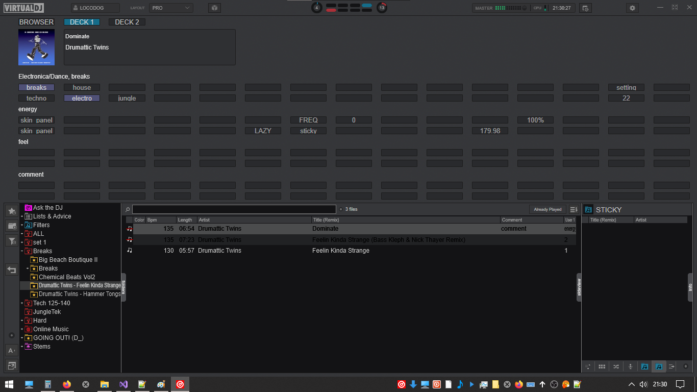

I've got an idea in principle for a simple skin interface to append tags. Horrible mouse work, but if you could script wouldn't be asking this kind of question.
Appending a single track is safe and easy, but multiple tracks, it gets a little spicy if you go wrong.
in principle it would be; user 1 & 2, comment, genre

Like I said, I'm working on it, point and click marking/filtering are possible.

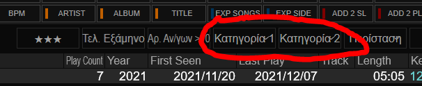

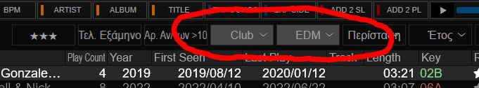

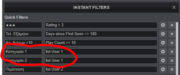

@Raddiks
Create two quick filter buttons with category and list as criteria.
Then it's as simple as selecting the two hashtags (one on each button)
Of course you can do it with 3 buttons as well (if you ever want to find tracks that have 3 specific hashtags at the same time)
PS: Sorry for the Greek language, but the screenshots are from my actual gig machine.
Also, generally speaking, the LIST criteria can be used in many cases to greatly enhance quick filters. It can also accept range, like list Year range 5

I actually made the point and click thing.
