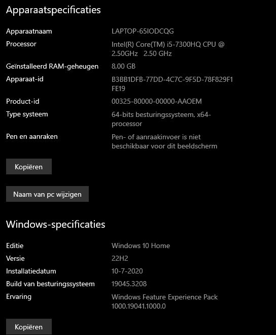

I have same issues. Virtual DJ on my laptop when not using any controller. But when I connect the Denon MCX 8000 to my ASUS laptop, stuttering and crackling starts. Now comes the clue. I connected the MCX 8000 to a Macbook Air and everything works allright. I bought this computer to check if this would work. And it does OK. Guys this is a real big issue! I work with Windows 10.

As I've said previously I'm sure it's an issue with a Windows update but probably impossible to diagnose.
People with different controllers and DJ software all reporting the same thing.
I've had updates on my Windows 10 DJ laptop disabled for probably 18 months now ad it all works perfectly with the MCX8000
