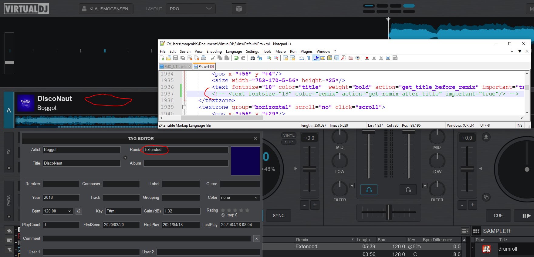

Sorry, you are right of course - it was just me being lazy because I just tried to answer it in the FB group where i first saw the question :)
Here is what I wrote:
Ok, so you have the info twice in the tags ,which is why it's shown twice
You can edit the skin.
As a test I removed the 4 lines with "get_remix_after_title" in lineno 1937, 1951, 2877 and 2891 in the pro.xml file (because I use the pro layout), selected the default (edit) skin that then appears, and now I don't get the remix tag shown in the title area:
You should be able to do something similar

By default the option cleanTagsInDeckDisplay is on, which will prevent the remix to be shown twice if it is both in the title and remix field.
