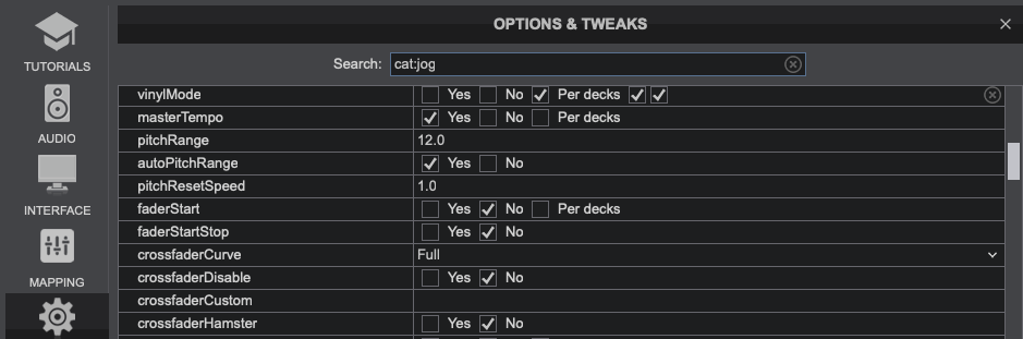

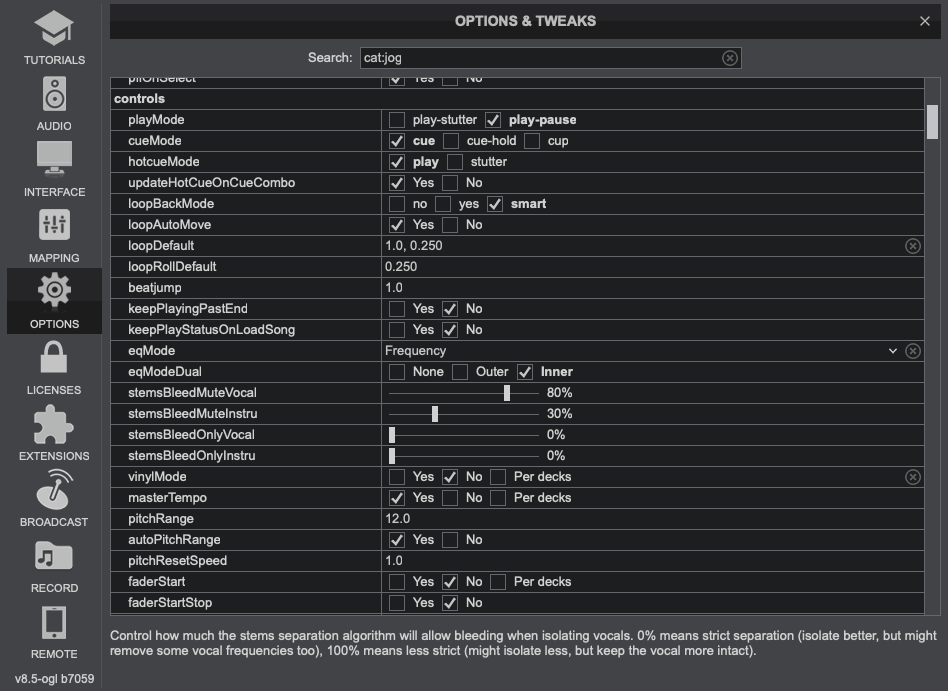

Thanks, I think I need to adjust the jogwheel's sensitivity now. Can you guys advise on exactly which options or setting here I should use to give me what I am seeking please as right now with the Vinyl mode set to OFF soon as I click on the jogwheel it;'s still stopping the platter momentarily.

As Rune has mentioned, Vinyl Mode needs to be OFF to achieve your goal.
In your great screenshots of settings:
1) the first screenshot shows Vinyl Mode ON for deck 2
and
2) the second screenshot shows Vinyl Mode ON for both decks 1 and 2.
Hope that helps.

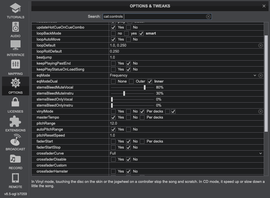

Wait, seems I am confusing myself here. Let me go through this again in slow-mo, this is the current setting:
https://i.postimg.cc/zGKmCWSd/Screen-Shot-2022-09-06-at-12-16-08-PM.png
is this setting correct to disable Vinyl and set as CD mode please?

No!
Your Jogs are in "Vinyl Mode" now...
First is for "yes" (Vinyl Mode) - second is for "no" (CD Mode)

currently you as shown by your screenshot, you have Vinyl mode set to NO and then turned ON individually for for deck 1 and deck 2, so Vinyl mode is ON in your case.
You should be able to see on the Skin.. that vinyl is highlighted, when vinyl mode is ON.

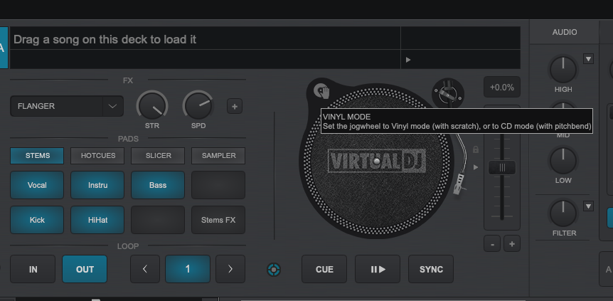

Ok guys, I am thinking this should be it so I select the 2nd checkbox from the left and leave out the "per decks" part then I X out from that window. Now when I hover over the top left icon on the jogwheel in each deck, it is showing Vinyl Mode [2nd screenshot below], what the heck am I doing wrong still??

This is only a "Tipp Text"
(what you can do with - tooltip)
-----> https://de.virtualdj.com/manuals/virtualdj/interface/decks/deckbasics.html

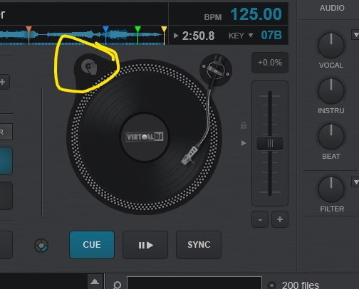

oh I see, thanks so if my last screenshot is showing the correct settings for cd mode then how can one know for sure when it's in CD mode? I have been looking all over the net for this info and only thing I have seen is that icon on top left of the jog wheel should turn color white which is doesn't on my end.
When a track is playing, click on the software jogwheel, if it stops then you know you are in vinyl mode.
I do not use the skin you are showing, but suspect it should change color cyan/red for deck 1/deck2 when in vinyl mode and gray(not full white) when in CD mode (vinyl mode OFF).
You are becoming a pro at this already :)
Posted Tue 06 Sep 22 @ 9:22 pm

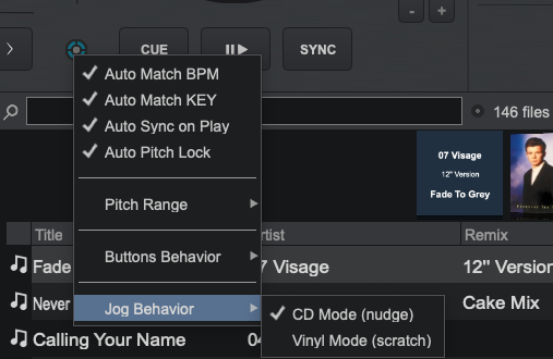

Actually guys, just got the info/help from support. This needed to be done inside the deck and not in Settings:
https://i.postimg.cc/D0S9VRt6/Screen-Shot-2022-09-07-at-8-22-48-AM.png
Problem now is, absolutely nothing is happening when I click inside the jogwheel so I cannot speed up or slow down, can any of you guys confirm this on your end for me please?

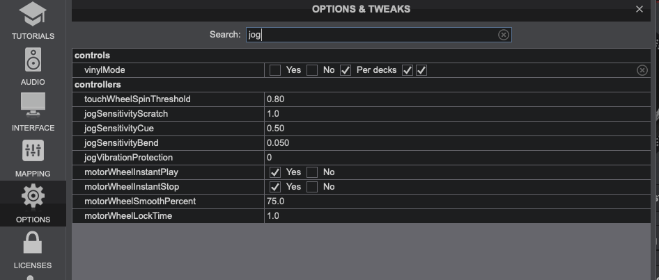

JogSensitivityBend = set by default
Posted Wed 07 Sep 22 @ 12:38 pm
Looking at every item in Options and Tweaks I am not seeing that listed neither in Decks options? Remember I not using a controller.
