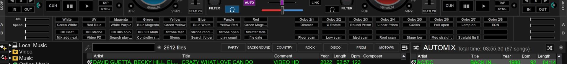

I'm using a modified version of Blocks to give me 64 custom buttons to control my moving heads by DMX and also a few other custom features. Problem is that the buttons are quite small especially on smaller screens.
Just wondered if it would be possible to develop a pop up screen for the buttons (similar to the extended browser) so they could appear larger then shrink again when not needed?

Sure...
Just wrap everything inside a <window /> element.
Then you can use
show_window 'MyDMXPanel' in a custom button on the main skin to show/hide the window
<window name="MyDMXPanel" width="800" height="600" posx="240" posy="100" shown="true" >
.... (your custom buttons and stuff)
</window>
Then you can use
