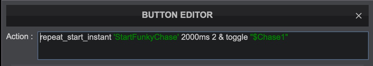

1- Created a custom button that I can trigger manually with code:
repeat_start_instant 'StartFunkyChase' 2000ms 2 & toggle "$Chase1"

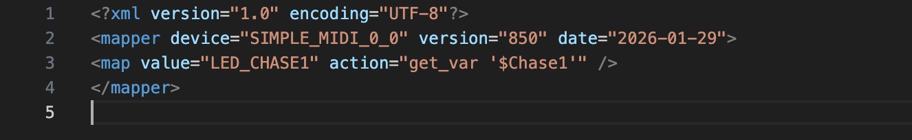

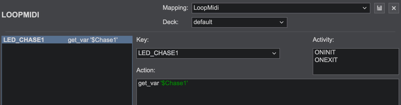

2- Added a mapping to the existing LoopBe mapping (which was empty by default) :
<map value="LED_CHASE1" action="get_var '$Chase1'" />
By looking at the existing file in the mapping directory, I found the file SIMPLE_MIDI_0_0 – custom mapping.xml that tells me that the name of the device is SIMPLE_MIDI_0_0

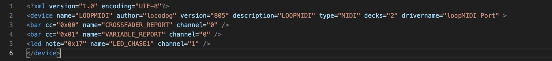

3- Created a VirtualDJ device for LoopBe (there was none) with the filename force-SIMPLE_MIDI_0_0.xml in the VirtualDJ device directory (the force tells VDJ to load the device to override the default device) with the suggested code:
<led note="0x17" name="LED_CHASE1" channel="1" />

you're going wrong at 3, simple midi is just a cover all for simple midi [no output to device], I believe devices with output [even virtual ones ] need to be defined, this is a defintion for midi in to LOOPMIDI [think it was in to soundswitch or unreal4]
The definition name is important, device name is important
LOOPMIDI.xml
LOOPMIDI.xml
<?xml version="1.0" encoding="UTF-8"?>
<device name="LOOPMIDI" author="locodog" version="805" description="LOOPMIDI" type="MIDI" decks="2" drivername="loopMIDI port" >
<bar cc="0x00" name="CROSSFADER_REPORT" channel="0" />
<bar cc="0x01" name="VARIABLE_REPORT" channel="0" />
</device>

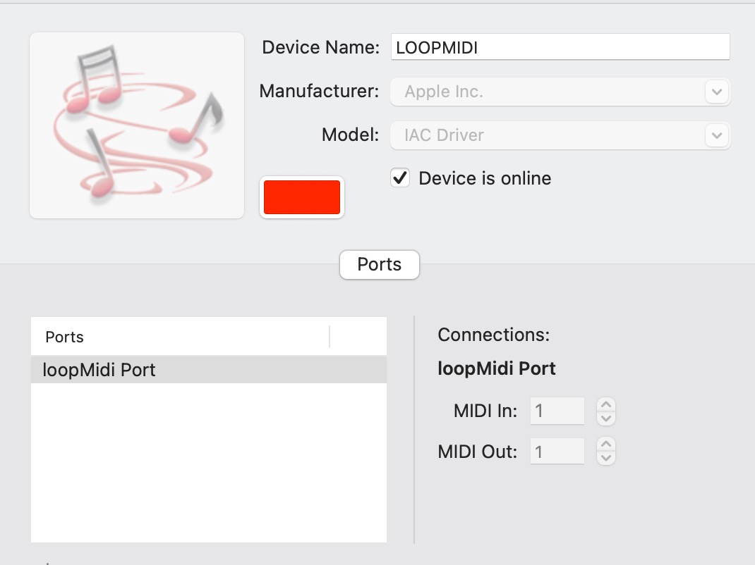

Step 0- Download and install loopMIDI from Tobias Erichsen which is available here : https://www.tobias-erichsen.de/software/loopmidi.html
loopMIDI is a software can be used to create virtual loopback MIDI-ports to interconnect applications on Windows that want to open hardware-MIDI-ports for communication.
Start loopMIDI, create a port in loopMIDI by pressing the ‘+’ icon.
Restart VDJ and your DAW (in my case Cubase). In your DAW, create a MIDI track and set the MIDI input device to loopMIDI Port.
Step 1- Create a custom button in VDJ that can be triggered manually with code:
repeat_start_instant 'StartFunkyChase' 2000ms 2 toggle "$Chase1"
Step 2- Add a mapping in VDJ to the existing LOOPMIDI mapping (which was empty by default) :
BTW, the mapping file is placed in the the VirtualDJ mappers directory (in my case C:\Users\myname\Documents\VirtualDJ\Mappers)
Step 3- Create a VirtualDJ device for LOOPMIDI (there was none) with the filename LOOPMIDI.xml in the VirtualDJ device directory (in my case C:\Users\myname\Documents\VirtualDJ\Devices) with the code:
</device>
</device>

This has got me stumped, I've followed along and believe I have all parts set up correctly. I just can't get the midi to connect to ableton, or show on midimonitor. I'm on Mac. Here's what i've got, does anything jump out as wrong? I'll keep messing
Device setup
Mapper setup
Button setup
Midi setup
Thanks
Device setup
Mapper setup
Button setup
Midi setup
Thanks
Posted Thu 29 Jan 26 @ 10:56 am
Mac doesn't need 3rd party apps, it has IAC driver that does the job, [but should work with 3rd party]
More importantly your .def and .mapper need the same device name [it's how they are linked]
.def for mac
.mapper
Also remember VDJ correctly starts counting midi channels from ZERO [because what is sent down the wire is 1 byte, 00-15, or 0x0-0xF in hex]
Most other programs start counting midi channel from 1 to 16
I've got a whole skin [with about 20 or so users] devoted to placing action poi quickly [no typing] and a full def and mapping to go with it. Especially catered to OS2L and MIDI note out.
Most recent iteration, is midi CC for a guy who jams on his guitar over tracks and the POI send midi CC to his multifunction fx pedal and looper.
If interested send me a pm.
.def for mac
<device name="MYMIDILOOP" author="locoDog" version="802" description="MIDILOOP" type="MIDI" decks="2" drivername="IAC Driver" >
.mapper
<mapper device="MYMIDILOOP" version="850" date="2024-03-01">
Posted Thu 29 Jan 26 @ 11:32 am
Superb mate, that's got it working, thank you. My aim is to get the faders on my controller sending midi out to control ableton, so for now i'll fiddle around till I get that working, Thanks for the heads up on your skin, i'll keep that in mind.
Posted Thu 29 Jan 26 @ 12:11 pm
oh right, so note with velocity as <LED> or maybe CC as <BAR>, I've done that kind of round trip before.
inbound Hardware talks to its mapping
mapping sets variables
outbound virtual device mapping watches variables
talks to virtual device .def
.def talks to IAC driver
IAC talks to DAW, lamping software, radio software, whatever.
