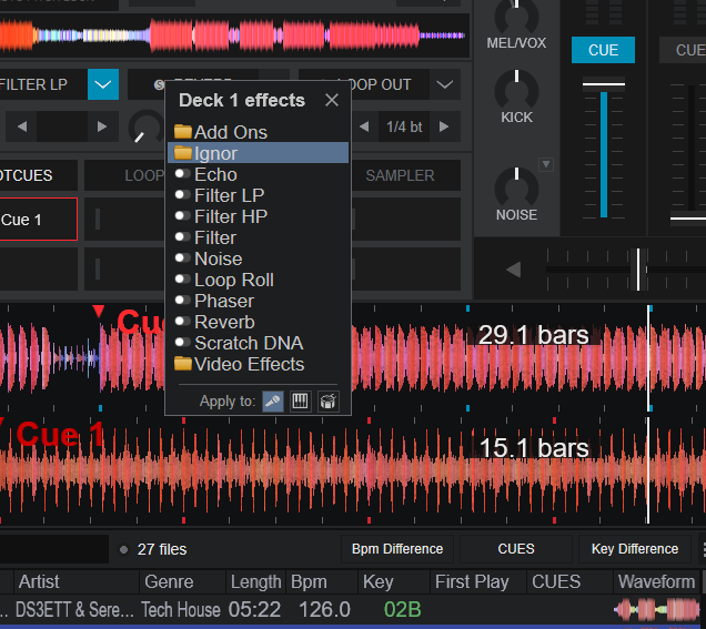

ok, so move all other fx you have to an "ignore folder" or "not on deck folder" like in the moving fx section and then share a screenshot of your effect_select pop up here
Posted Tue 12 Apr 22 @ 1:51 pm
Thanks!...Here are the ones but the scroll goes into all the folders unless the dropdown list is open, I was wanting to avoid having to open the drop down list. Was also wondering where the color effects are located? Would be nice to have a custom button to scroll through those as well without having to use a mouse. This controller doesn't have the option to select. Thanks for your help!

ok so you have only a button on the ddj400 for fx select, you won't need the list open
looks long but the really meat of it is
effect_select 'scratch dna' ? effect_select 'echo' : effect_select +1
is dna on slot, yes jump to echo, no dna isn't on slot move down list,
the filler is repetition for decks & master
you could do similar for colour fx but there are other ways too [like 4 slots for them perdeck] depends on you & what buttons you choose.
native fx don't have a location, just a shortcut to the fx in the app [looks and acts like a location but is just in the app]
var '$DDJ400_FXASSIGN' 1 ? deck left effect_select 'scratch dna' ? deck left effect_select 'echo' : deck left effect_select +1 : var '$DDJ400_FXASSIGN' 2 ? deck right effect_select 'scratch dna' ? deck right effect_select 'echo' : deck right effect_select +1 : effect_select 'scratch dna' ? effect_select 'echo' :
deck master effect_select 'scratch dna' ? deck master effect_select 'echo' : deck master effect_select +1
