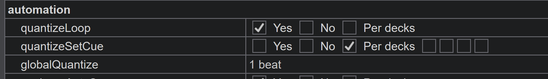

1) How does one change by script, the option/setting for quantizeSetCue when the choices are Yes, No and Per Deck?
seems that
setting 'quantizeSetCue' 'yes' << does not work
setting 'quantizeSetCue' 'no' << does not work
setting 'quantizeSetCue' 1 << does not work
setting 'quantizeSetCue' 0 << does not work
2) and how does one with script choose the Per Deck?
setting 'quantizeSetCue' 'yes,yes,no,no' << does not work to have it On for decks 1&2, and Off for decks 3&4
the settings.xml would show:
<quantizeSetCue modified="yes">yes, yes, no, no</quantizeSetCue>
seems that

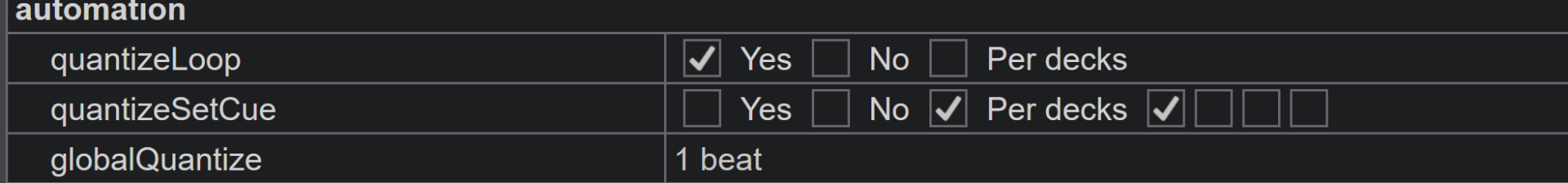

It seems for me that quantize_setcue is deck specific, for example if I create a custom button on deck 1 with:
quantize_setcue on
or
quantize_setcue 1
and look at the options setting for quantizeSetCue it will show only the per deck (deck 1) checked as ON.
Not the first, Yes, box, for all
its only with :
deck all quantize_setcue 1
do I get a Yes in first box.
And seems not to be a way of setting the check box for, NO with a script, maybe, since
deck all quantize_setcue 0
results with (which is workable, since all per deck, settings are unchecked ):

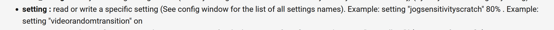

Again wanting to learn, I was initially thinking one would change this option with the setting verb, per its description.
which I cannot get to work.

Correct.
on and off without quotes are treated as boolean yes/no parameter, 'on' and 'off' with quotes is treated as text.
quantize_setcue is indeed a little more relaxed in that it also accepts 0 and 1 instead, but otherwise there's no difference.
I think there's indeed no way from script to change it to 'no' instead of per deck.
