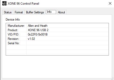

Hi,
I'm testing the latest VDJ beta with a recently purchased A&H Xone:96 mixer. Once the asio drivers are installed, VDJ only allows me to configure it as a sound card at 44khz, unlike Traktor which reaches the maximum which is 32 Bit / 96Khz. I have tested both directly and through the asio control panel.
Can this be fixed somehow?

Probably open the asio driver, and change there
did you try that?
did you try that?

Yes i tried that.
Sorry, from there i can“t.
The control panel has no option to set 96Khz.
Please, look at the screenshots to see that in Traktor and Mixxx there is an option inside preferences to configure it.
Thanks.

are you able to change the sample rate setting under Virtual dj option page?

I think this option is not the output quality of the Sound Card, but rather the internal samplerate of VirtualDJ.
If set to auto, VirtualDJ will use the samplerate recommended by your sound card.
As a rule, a bigger samplerate DOES NOT mean a better sound quality, on the opposite. The best quality is when your source file, internal samplerate, and sound card, all use the same value.

If the ASIO driver supports it, then the samplerate will be set to the samplerate selected in VDJ, so it should work to select 96000 in VDJ.
But, as you said yourself, a higher samplerate does not result in better quality so there is not really any need to use 96kHz in the first place.
