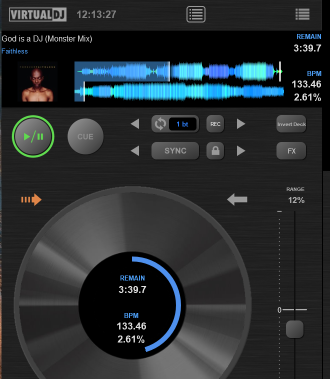

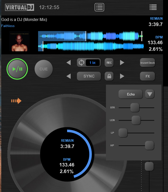

Work on my new skin is progressing nicely, but I have got an issue I cant work out..
On each deck I have a button which displays a small FX panel over the deck graphics as below
Unfortunately I cannot stop activating the elements on the deck panel when over the FX panel.
Is there a way of blocking the panel underneath so the mouse cannot react to it? Is <mousemask> the answer? If so, I don't know how to implement it :(

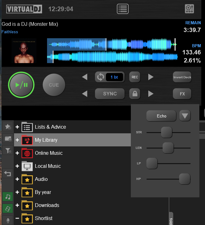

          If a solution is possible I would also like it to work over the browser panel too :)

          Ah I see!
The problem exists for all elements underneath, not just the scratch zone. I have buttons and pitch sliders which interact as well.

          That works a treat!! Thank you PhantomDeejay :D
You are correct that it does not work when the panel is displayed over the browser, but selecting a folder is less of an issue that interacting with the deck platter controls.. I can certainly live with that :)
