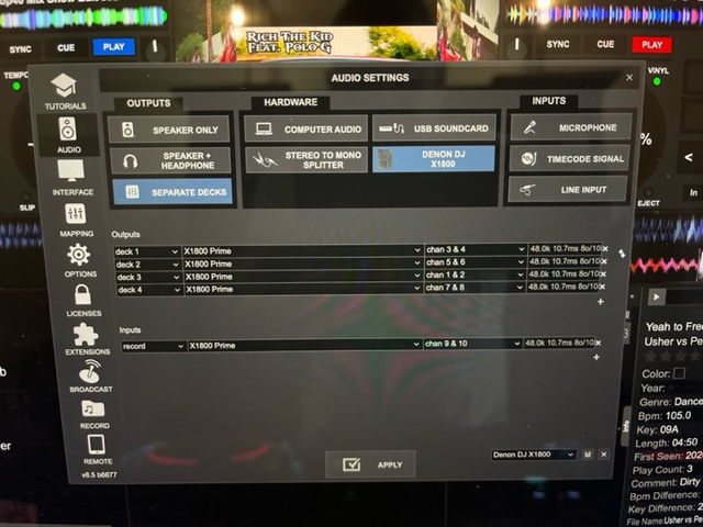

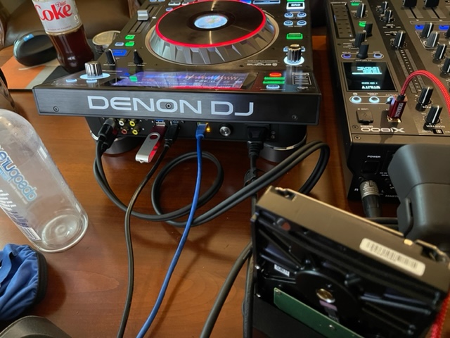

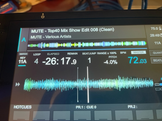

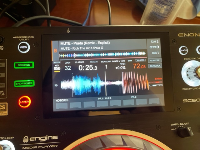

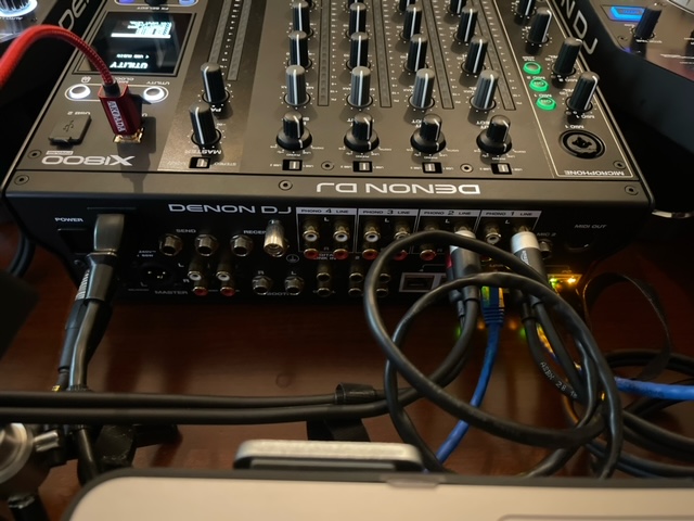

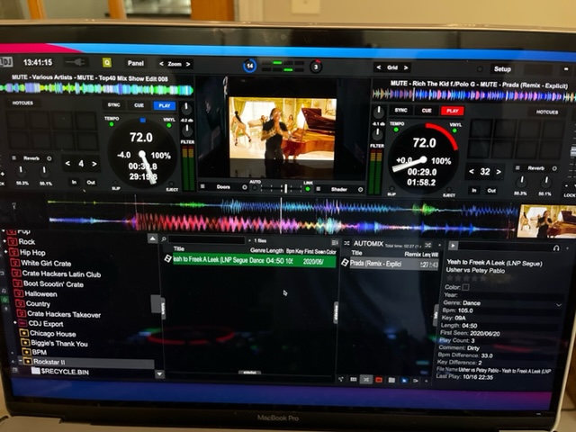

Trying to set up Denon X1800 and SC5000.s w/ VDJ. Not sure what the sound settings or hookups should be, I have them all linked and the X1800 USB'ed to the computer, then I could not see the SC5000's. I usb'ed all 3 then they showed up but when playing it shows muted in VDJ and on the SC5000's. Can anyone help?

The X1800 is your soundcard, just use that.

I believe you asked the same Q in another topic.
If MUTE is displayed on a Deck, it means that the (Denon X1800) Mixer Channel Source selector is not on USB position.
