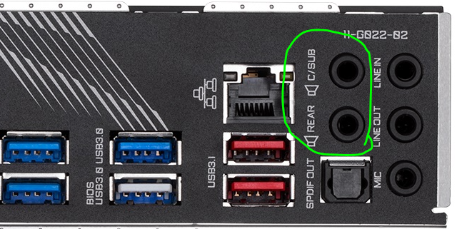

Try connect speakers for example to Rear output and Headphones at Front outout (or vice versa)
And then in VirtualDJ try what channel that is in the last drop down for master output. Channel 1&2 or Channel 3&4 etc.. If the channels have no names appended, it might be a little bit of testing before you find the correct one (unless labelled "rear" and "front", then its easy ;-))

Does your computer have multiple output at back.. not only line-out. but also, rear, front etc
And just to make sure Windows didnt mess up, check if its actually set to surround as well

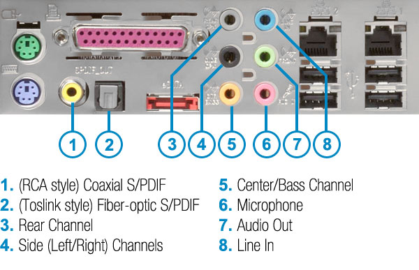

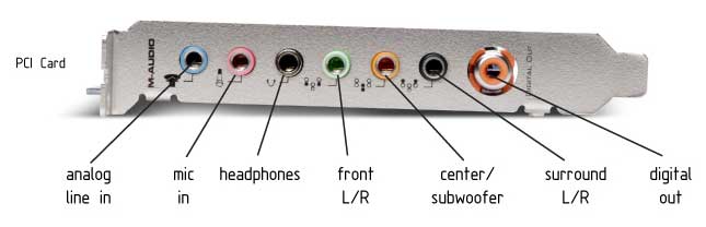

Typically you might have something like this
(and in case others read post in future and have different surround card..)

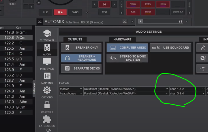

Did you set headphones to different channel output than speakers (master) in VDJ settings?
Look at the last drop down for each entry, they can not be same

Under headphones under i have 2 more options, when i choose one of those, vdj switch automaticly to usb soundcard, not computer sound ?
Master = speakers chan 1 and 2
Headphones = i have 3 rows
Speakers
Realtek digital output
Nvidia high defination audio
And when i choose the last 2 options, vdj automaticly change hardware from computer audio to usb soundcard
Speakers

Well ok choose
main - speakers - chan 5 and 6
headphones - speakers - chan 1 and 2
this way main output should be REAR and the headphone both Front jack and LINEOUT
(do not take care about the selected buttons, they are automatic for VDJ use)
as well using NVIDIA chan 1 and 2 as headphones can make the monitor send PFL
and use its headphone jack (if any) for the headphone
(in any case do not use "Digital", this is the optical link)
Posted Sat 17 Apr 21 @ 6:04 pm

And not sure what the video was, you need to use the PC sound card and change CHANNEL at last drop down instead of the sound card select drop down
