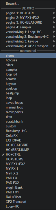

Hi, I have exactly the same issue. I created some new pages to rearrange FX according to my needs. Everything works fine; except for the colors. The page is reflected in VDJ as it should be, including the functions, colors etc. When I push the pads on the XP2, the functions are activated as expected. However, the pad color within VDJ did not transfer to the XP2.
This is only for PAD MODE 5-8, what I call the SHIFT MODUS. For PAD MODE 1-4 everything works like a charm.
I thought it might be related to the pages I newly created. But, I removed these, got the originals back and the same issue is still there.
Here's an example:

When I map the new page to PAD MODE 1, the colors transfer correctly.
When I map the same page to PAD MODE 5, the colors of PAD MODE 1 remain, but functions work perfectly.
Now, wouldn't mind 'cause the functions work, but it's confusing...
Don't have a clue how to solve this
How do you assign your pages on XP2 ?
Via GUI ? Or by changing the mapper ?
Via the GUI
The page really changes; functions are available.
But, the color scheme isn't transferred.
Ok, we were able to identify the issue and will be fixed on next version.
