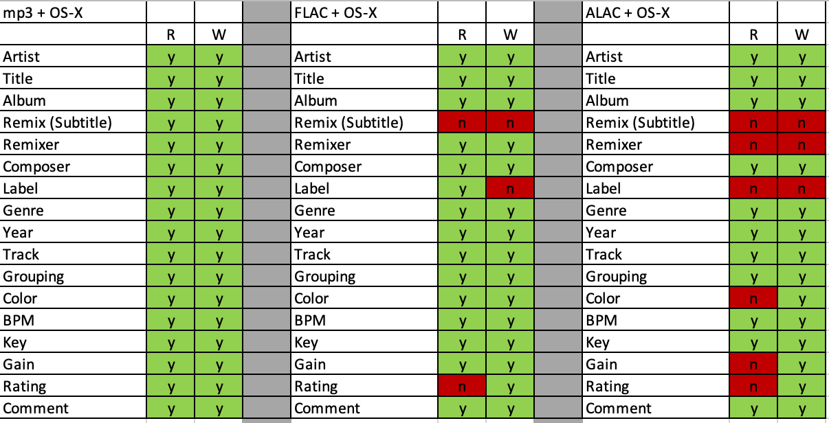

Some more troubleshooting. I tried different formatted drives on OS-X (AFPS and FAT32) to take that variable out. I also noticed the are some read and write issues. So I put it in a grid format.

Can anyone ping me just to let me know this is on the list of fixes for the future? I've paused a significant retagging project to make sure I am not doing things in vain.
Posted Mon 11 Jan 21 @ 4:32 pm
Not all combinations of read and write are currently supported indeed.
We are working on a full list of which tags are supported by which file formats.
Posted Mon 11 Jan 21 @ 5:51 pm

So just for clarification, there is no fix in the pipeline. It will just be a list of supported tags per format?
Posted Mon 11 Jan 21 @ 6:53 pm
Such a list is being produced yes ;-)
Posted Mon 11 Jan 21 @ 7:30 pm
