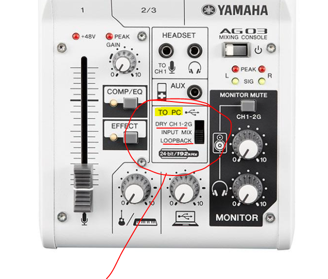

A Yamaha AG03 I dont know well, but apparently it might be able to route the mic back to the computer, but not sure.
If so, try set the Yamaha as the mic input in VirtualDJ https://www.virtualdj.com/manuals/virtualdj/settings/audiosetup/microphone.html
It also looks like the mixer has a switch to select what sound to route back to the computer. Either channel 1 (mic) or loopback (probably means all sound at the mixer).

ok thanks so much. i'll try with the mixer again and adjust that switch.
i was also on live chat with vdj (which seems to be closed now) and he said i shouldn't need a mixer either. but in vdj it doesn't allow me to turn on/off the mic through the software. under "master", where the mic volume , on and rec buttons are, n othing happens when i click on those. any idea why that would be?
