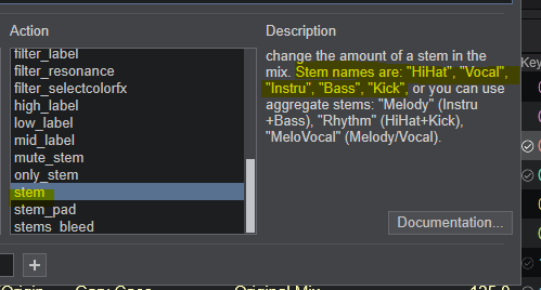

Easy to find what to use if you look in the custom button descriptions.
Just replace vocal and voc* in the above script with intru for instrument
