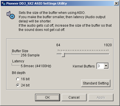

change it on the aiso driver setting panel this is not inside VDJ

Leave the VirtualDJ one at 0.
(means automatic)
Then change the buffer at the Pioneer utility program for the driver instead.
Posted Wed 11 Nov 20 @ 11:18 am

Not entirely sure what you mean..
There is only one "asio panel", and that is from Pioneer (see image above).
You might have a shortcut button in VirtualDJ sound settings to open the Pioneer settings, perhaps thats what you mean.
But it solely opens Pioneers own asio driver settings.
If the settings in Pioneer dont "save", try change at the Pioneer utility before you open VirtualDJ.

When you click the ASIO button in VirtualDJ audio settings, can't you change your buffer from there ?
My guess is that when you open the panel outside VirtualDJ it gets called for 32 bits application
When you call it from inside VirtualDJ 2021 it gets called for 64 bit applications (since 2021 is a 64 bits app)
The Pioneer ASIO drivers are "dual layer" (same driver encapsulates both 32 and 64 bit drivers)
So perhaps they keep a different setting depending the 32 vs 64 bit mode.

Hi, Thanks for the reply. Yes you can change the asio panel in the vdj audio tab but as you go back to the panel inside vdj it defaults back to 256.

OK well it seems like whatever you set in the Pioneer ASIO window, VDJ defaults to 5ms when using the SX2 ASIO driver.
No performance issues anyway, so IMO not a problem.

OK so I have been experimenting:
I ran VDJ 32 bit on my old Windows 8.1 laptop and noticed that I could adjust the buffer size in the Pioneer util, and VDJ would refresh and show the change in the audio config - so I wondered what the difference was...
It's down to the 'latency' setting in VDJ performance settings. If that is set to a fixed number (say 256) then no matter how much you adjust the Pioneer settings, VDJ will default to 256.
If however you set 'latency' to auto (or 0 as Rune suggested) then it will allow you to set the Pioneer slider to whatever you like.

Groov you're a genius. I truly can't thank you enough for your work on this. Who would have thought it was something that simple!?
