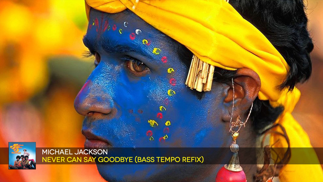

Created a dark mode version with font and style to match what I do in Final Cut Pro:-)
