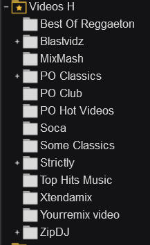

I have + signs next to folders, that "don't" have sub-folders. If I click on them, they disappear. This has been going on for some time, but did not affect my playing. However, I thought I should report even if it is a small annoyance.

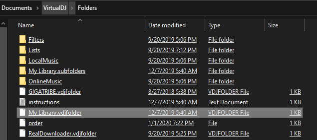

This is what I see when I do what you said.

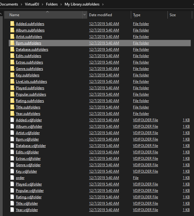

If I go to the next step, I see this.

OK, it's not the my library as it has specific subfolders in place.
If they are there they would be in the root of the folders folder.
Try searching the folder for strictly and see what comes up. All that should be there is strictly.vdjfolder
