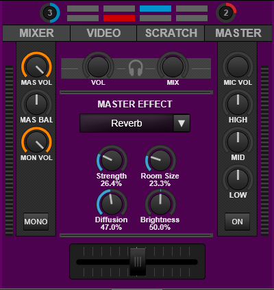

I added the mic EQ controls to the old default skin a while ago.
It's also possible to add a mic effect section if you wanted to use a compressor, reverb etc.
Posted Sun 05 Jan 20 @ 6:21 pm
A gate would be nice..that sure did come in handy so folks didn't hear my dog when she barked!...im adding the eq to the skin now...thanks for the pic...but which ones are for the mic eq?...are those the 4 knobs in the middle that appear to be custom?..I added the eq nobs..it does sound better...not as good as vm did..but at least i dont have to deal with vm anymore.

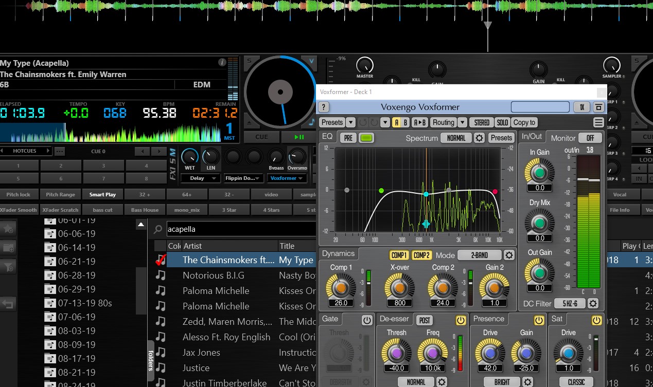

here's one example of a vocal vst plugin

most are i haven't been able to get any of the waves plugins to work in VDJ though. if anyone has please speak up :-)
i know these work and many are free https://www.voxengo.com/
Posted Mon 06 Jan 20 @ 1:01 am
I got one of the wave plug ins and couldn't get it to work either. Thanks for the link to the ones that do!!!
Posted Mon 06 Jan 20 @ 2:03 am
make sure u test with the demos before u spend any money :-)
Posted Mon 06 Jan 20 @ 2:23 am
Will do!!..thanks for that!...i did not know you could demo!..now it do!!...and thanks again for Loudmax...it was a saver for sure!!..xD
