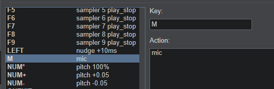

"Mic" just means VDJ will threat it as a "special" or as a separate auxiliary channel. The source for that channel can be anything that is available in your system, incl. the mic you have now assigned for the "Line in".
This then allows you to assign a key shortcut to it in Controllers -> Keyboard. For example, I've assigned the "M" key to toggle the mic:
Alternatively use tjhe action "mic_talkover" if you want the mic on only when the key is pressed.

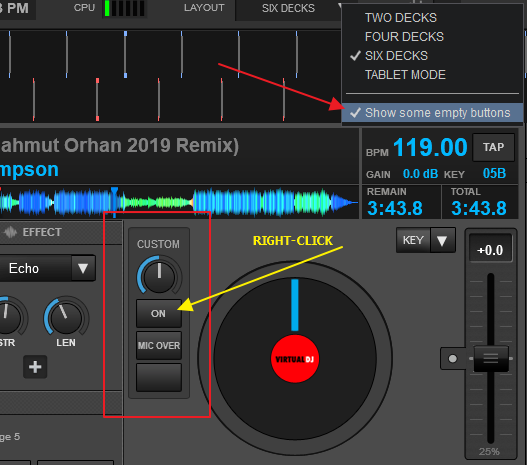

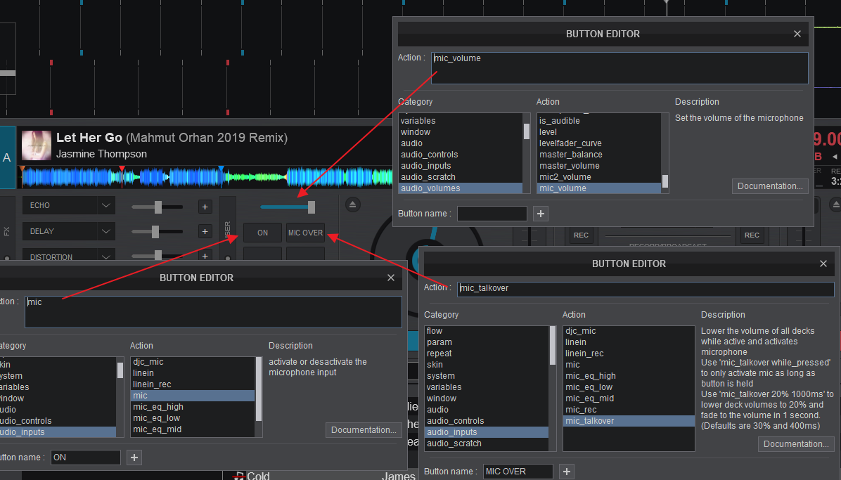

You probably have it all wrong, so i will try to explain in simple steps as possible...
1. Audio Setup. You just need Master and Mic in your Audio Setup. If you are not sure, post a screenshot here.
2. You dont have to use any Deck to input the Mic. So make sure no linein or linein 'mic' is enabled on any deck. In case you still see "Line Input" or "Microphone input" on any deck, without you pressing anything, let me know.
3. All you need to use is skin that offers just the decks you need to mix. You dont have to use a 6 Decks skin, because you dont need any spare Deck for Mic.
4. Below is an example of custom Buttons, in order to have all Mic controls in front of you and not having to switch from Audio mixer panel to Master panel.
buttons are mapped as .. mic .. and mic_talkover
slider is mapped as mic_volume
To edit/assign an action to the Custom buttons/slider (to get the Buttons Editor), you need to right-click on the button/slider.
Screenshot is from Default -> Pro skin. You can choose from the top LAYOUT menu if you want 2 or 4 decks for your mix.
Let me know if that works for you and then we can help with the Mic Effects or any other functions.

Gloomer2000 wrote :
But anything of this is working, if I right-click, nothing happens.
Open VirtualDJ Settings-->INTERFACE tab-->Select the "Default" skin (the very top one).
Close Settings.
From the top LAYOUT menu, select the "PRO"
Follow the steps i wrote above.
But if you still want to use the "old" skin, make sure you have the Custom buttons available.
Right-click on a Custom button works fine in both cases (opens Buttons Editor to assign an action)
Once assigned, of course you need to click on those buttons in order to get the assigned functionality.
Posted Sat 16 Nov 19 @ 10:26 am

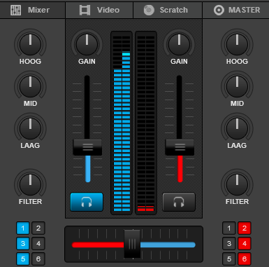

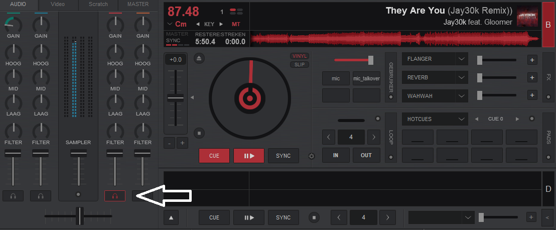

Hey hey,
I'm working all day on VDJ and everything seems to work well.
Only one thing :
When I load a track in a deck, my headphone icon is lit.
And I hear a terrible reverb/delay.
I don't want that of course, because this sounds terrible.
Here is a screenshot.
Thanks is advance guys...
Only one thing :
Posted Sat 16 Nov 19 @ 3:24 pm

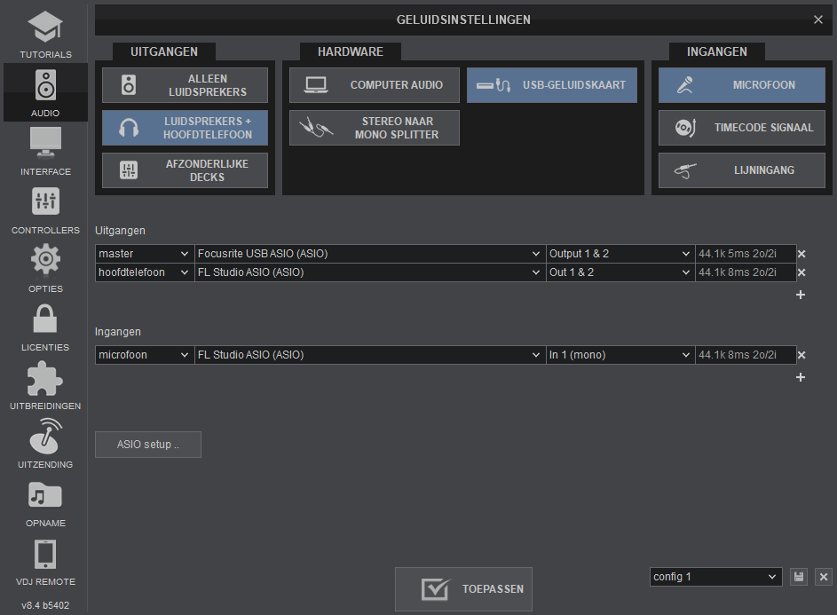

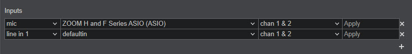

I recommend posting a screen shot of your audio settings.
Posted Sat 16 Nov 19 @ 7:58 pm
Here you go buddy :-)
Thank you !!
Posted Sat 16 Nov 19 @ 8:26 pm

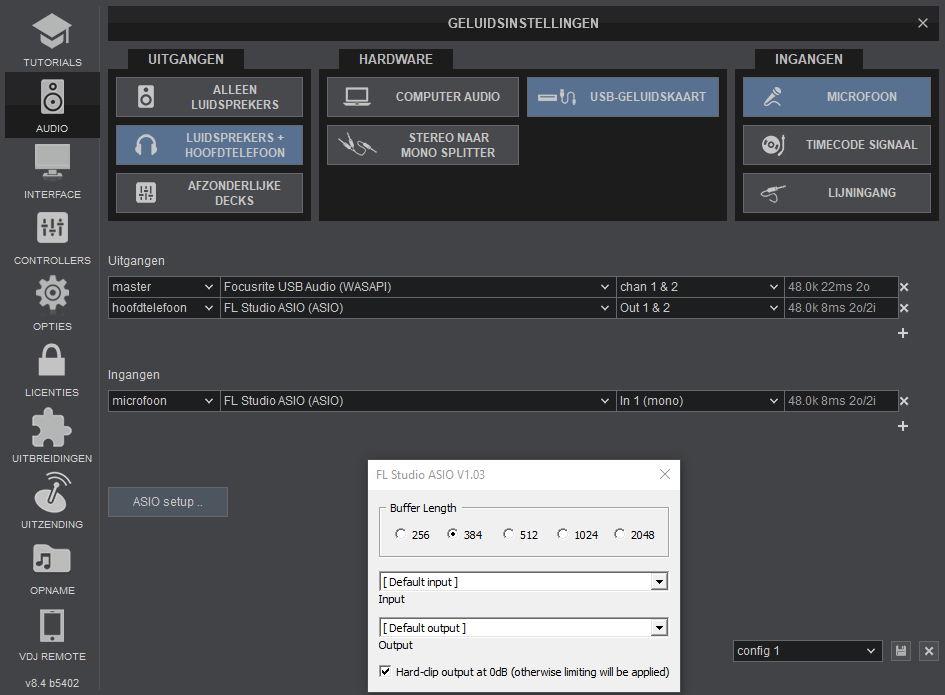

I believe the headphone CUE will automatically switch if the option is turned on in settings.
I have had issues with two ASIO interfaces working at the same time. I've had better luck with WASAPI when using multiple sound cards.
DJDAD might be able to advise better on this. But, I would try switching to the WASAPI interface options. I have not noticed any delay difference between WASAPI and ASIO with my DDJ-RX.
Posted Sat 16 Nov 19 @ 8:50 pm

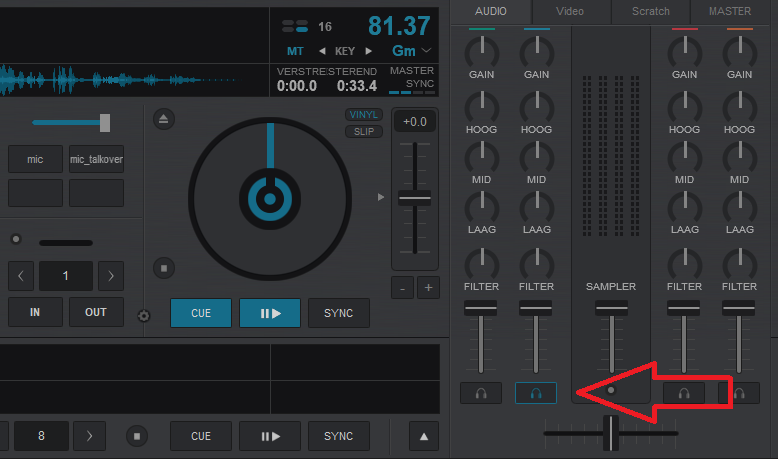

Hello,
An update.
I installed the latest driver from Focusrite..
Everything seems to work well, except that my microphone icon is lit when I drag a song into a deck.. And then you hear a terrible reverb.
I always forget to disable that icon when practising my Dj'ing.
The problem seems to be that I don't have software to control my external harddrive.
So no Focusrite Scarlett interface on my computer.
I will call the seller tomorrow and see what is wrong.
Thank you all for your kind cooperation.
Greets
Gloomy.
Posted Sun 17 Nov 19 @ 11:20 pm
The external hard drive should have no factor in this.
Have you tried not using ASIO for both devices at the same time?
Try just WASAPI drivers for both interfaces.
Posted Mon 18 Nov 19 @ 5:36 pm
What's confusing me is how FL Studio is involved.
That's DAW software, not an audio interface, so why is it showing as a driver?
Posted Mon 18 Nov 19 @ 5:53 pm
