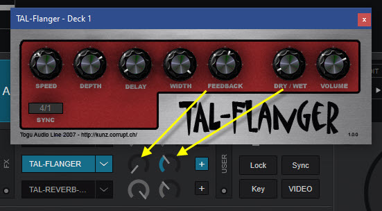

Is there a way I can manually map VST params (knobs in this case) from 3.-party plugins to the two main buttons shown in the VDJ user interface?
For example, say I would like to map/bind the feedback and wet/dry knobs - is this possible?

Yes you can, but I think you'd need to edit the skin XML.
Basically the two VDJ knobs control parameter 1 and parameter 2 of an effect. The knobs on your VST (assuming they're mappable) would likely be parameter 5 & 6.
If you edited the knob code in the skin, those two knobs would always control parameter 5 & 6, regardless of effect - unless you used a more complex script that checked to see if TAL-FLANGER was selected first.
Either way, it's a faff. It would be nice if the parameter the knob controlled was selectable from a drop down menu, so you could re-assign it if needed. Again, possible by editing the skin I believe.
[edit] I just had another thought. It might be easier for you to map a couple of custom knobs. Also, see the page on using VST effects in the VDJ manual. It covers controlling them via MIDI.

Currently only sliders #1 display and and #1 and #2 in old skin
As groovindj said this badly needs some specific skin modification
maybe a menu to select which sliders to display or +/- buttons or up/down arrows to navigate available sliders the same way actually navigate effects in FX1 would be a good suggestion

Thanks guys.
I was able to remap by editing the XML file as you suggest. For now I simply hard-coded the numbers since my effects are pretty "fixed", but a conditional check is probably more optimal.
For anyone interested in case you use the TAL Flanger plugin, I had to use slider IDs 7 and 8 (probably some non-GUI automation/bypass etc. parameters prepending the knobs themselves):
This is the section I changed, more specifically the lines containing
The full section:
Repeat for deck 2 etc. Search for "fxknobs_slot2" (or ..slot1 etc. whatever effect slot you use) to find the location(s).
Works like a charm.
I was also looking for a bridge plugin which could remap the params between the host and the plugin (not sure if jBridge can do this). But editing the XML fixed it for me for this time.
Thanks again!
<slider action="effect_slider 2 8" ...
The full section:
<group name="fxknobs_slot2" y="-2+37">
<panel class="knob_modern_small" x="+187" y="+0" visibility="effect_active 2">
<slider action="effect_slider 2 8" dblclick="effect_slider_reset 2 8" disabled="not effect_has_slider 2 8" frommiddle="get_effect_slider_default 2 8 0.5"/>
</panel>
<panel class="knob_modern_small" x="+187+45" y="+0" visibility="effect_active 2">
<slider action="effect_slider 2 7" dblclick="effect_slider_reset 2 7" disabled="not effect_has_slider 2 7" frommiddle="get_effect_slider_default 2 7 0.5"/>
</panel>
<panel class="knoboff_modern_small" x="+187" y="+0" visibility="not effect_active 2">
</panel>
<panel class="knoboff_modern_small" x="+187+45" y="+0" visibility="not effect_active 2">
</panel>
</group>
Works like a charm.
