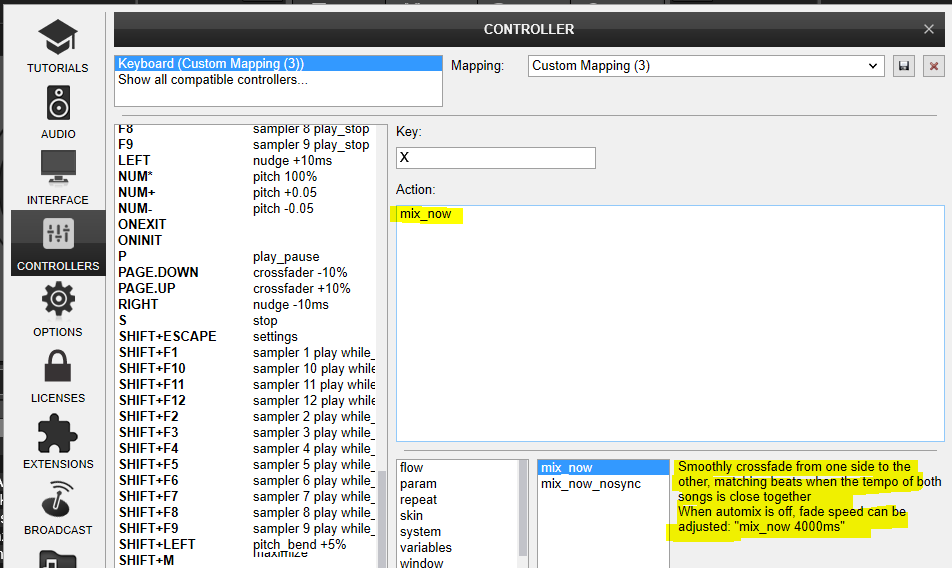

Just mix_now you mean? (and not mix_now_nosync)
Can easily map to any keyboard and button in the controller settings (see image)

the problem with "mix_now" setting is that when the automix is off there is no automatic beatmatching DURING crossfade.
Posted Thu 28 Mar 19 @ 10:08 pm
Should be automatic beat matching, if you are using mix_now (and not mix_now_nosync, that does not beat match)
Posted Thu 28 Mar 19 @ 10:12 pm
I tried it and it doesn't when Automix is off. It should slowly reset the pitch to 0 during crossfade ,beatmatching like it does when the Automix is on and i forceFade by pressing mix_now button (which it works when Automix is on). Basically , is to be able do the same action when the automix is OFF
Posted Thu 28 Mar 19 @ 10:54 pm
Well thats part of automix doing more than mix now .. .
You can map one button to mix_now => does the beatmixing part, that obviously needs to change pitch if songs are not same bpm.

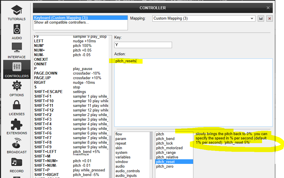

Then map other button to pitch_reset to reset the pitch slowly if the pitch change is more than you want to keep

Or you can combine the two, with something like :
mix_now 4000ms & repeat_start 'wait' 4000ms 1 & nothing & deck playing pitch_reset 0.5%
Adjust to own preference of speed of crossfade (4000 milliseconds in example) and speed of pitch reset (0.5% pr second in example)
repeat_start 'wait' 4000ms 1 & nothing is basically just waiting until crossfade is done before applying pitch reset.
Posted Thu 28 Mar 19 @ 11:58 pm

I set it to "mix_now 4000ms & pitch_reset 0.5%" . It resets gradually to 0 during crossfade . Mix_now 4000ms & pitch_reset 4000ms resets simultanuesly. Thanks for the guidance.
Posted Fri 29 Mar 19 @ 7:51 pm
