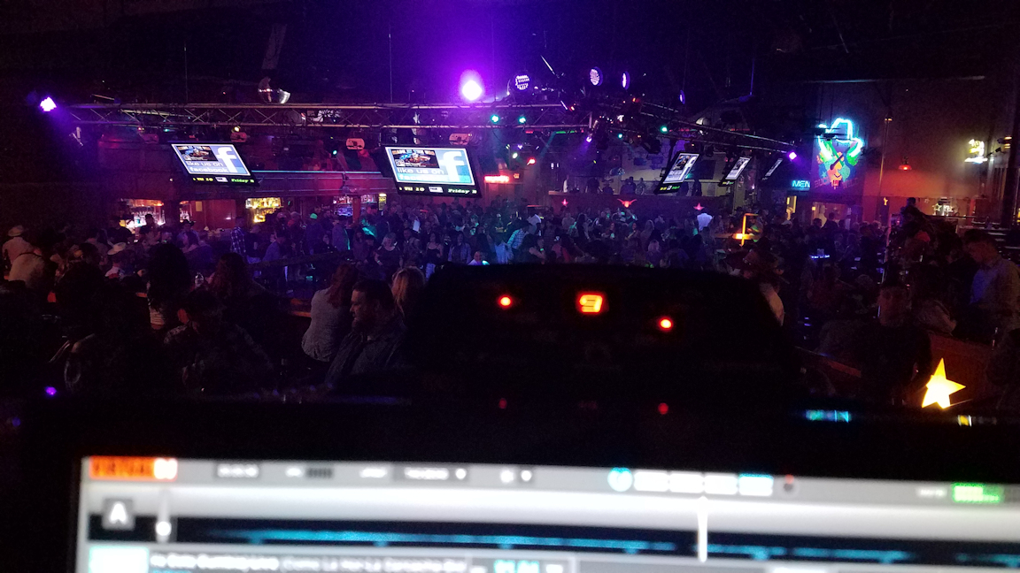

VDJ is Club/Festival ready.
I have used VDJ in many different clubs, I’ve played at the Hard Rocks inside and outside stage for thousands of people and not once have I ever had a complaint, in fact I had the complete opposite.
The sound guy at the Hard Rock said I sent one of the cleanest signals of any dj that he’s had.
I play everything from trap music to country music and never once had a complaint.
This includes clubs, festivals, weddings and just parties in general.
Posted Mon 14 Jan 19 @ 2:08 pm
