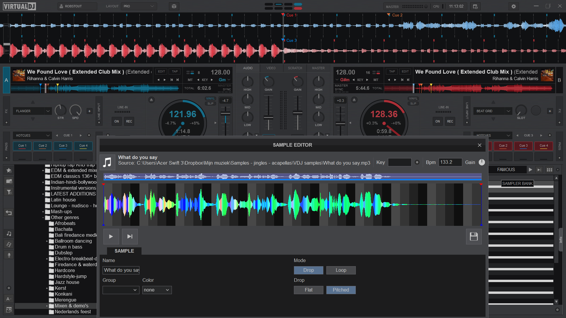

I have a 133 bpm sample mapped as 'sampler 1 play_stop' to a button on my controller (specifically the FX1_ASSIGN_3 button on my Denon MC6000Mk2 controller), and in the Sample edited it is set to Pitched mode so it plays in sync with the track. Back in the days in VDJ 7 this sample would always be played in sync with whatever track was playing on either deck. In VDJ 2020, it only syncs with the left deck but never with the right. So when I play the sample using the mapped controller button while a track is playing on the right deck, it's not pitch matched and obviously plays out of sync. Strangely when I play the sample using a mouse click on the sampler bank in the bottom half of the screen, it does play in sync with either deck.
The FX1_ASSIGN_3 button is on the left half of my controller. Interestingly, if I map the same sample to the FX2_ASSIGN_3 button on the right half of my controller, the sample does play in sync. So it seems that the software sees the button as belonging to that deck. However as said in VDJ 7 that wasn't the case and the sample would always play in sync with the same button.
So I suppose I just need to enter the right script for the controller button to act the same as the mouse click, and ignore which deck is playing. But what script should it be?? Can you help me out?
I have already tried using the pencil button in hte mapping overview but it won't enter the script when clicking on the sample.

Sample settings:
https://virtualdj.com/img/383247/35780/VDJ%20screenshot%202.png
(changing it to loop mode with any other mode like sync-lock does not make a difference)
