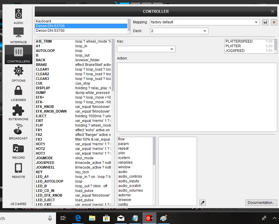

Sorry for jumping in late.
Manual will be uploaded soon. The default behavior is indeed a bit tricky, especially if you dont have anything to read, but in general the EFX knob provides effect selection (and param adjust when Fx is enabled) and triggering on push, when one of the 3 FX1, FX2, FX3 buttons are used. When not, the knob adjusts the size of the loop
Anyways here is an approach to use 3 FX slots
FX1
FX2
FX3
LED_FX1
LED_FX2
LED_FX3
EFX KNOB
EFX KNOB PUSH
LED EFX KNOB
When FX1 is on (LED blinks), the knob controls the FX slot 1 (selects or adjusts the 1st PRM if enabled - push to enable)
When FX2 is on (LED blinks), the knob controls the FX slot 2 (selects or adjusts the 1st PRM if enabled - push to enable)
When FX3 is on (LED blinks), the knob controls the FX slot 3 (selects or adjusts the 1st PRM if enabled - push to enable)
When none of the FX1, FX2, FX3 are on (none of the Leds blink), the knob adjusts the loop size and push to turn on/off
Let me know if you need further adjustments or different behavior. If you are satisfied with the above, i could add some further actions to the scripts to show texts on the LCD
Regarding your other issue (left deck playing at the right and vice versa, there are 2 things here..
1 Control. Try to enable e.g. a loop from the Denon unit. If it enables the loop on the wrong deck (watch the GUI), then it means that you need to assign the units to different decks , from VDJ Settings-->Controllers tab, where you select the device from the left side list and assign the correct decks on the right side
2. Audio routing. Regardless the correct Control (see above), the audio routing needs to be adjusted from the AUDIO tab of VDJ Settings, where you may have to swap the Channels (or sound cards), but thats mostly up to the used sound card, so best would be to post here your Audio setup.

Thanks so much djdad.. This is kinda how the support had it hooked up. Thanks a lot. Can't do it now but I will ASAP
He made use of my trim button some how. I forgot how... I think... ny holding the trim button and pressing down or scrolling the rotary knob did something (Scroll through banks?)
So... In order for me to scroll through the fx… an effect has to be on? there's no way around this? This is what happened before then... what effects readily available werem't what I wanted and all I could get it to do was scroll the loop and I couldn't get it to exit...

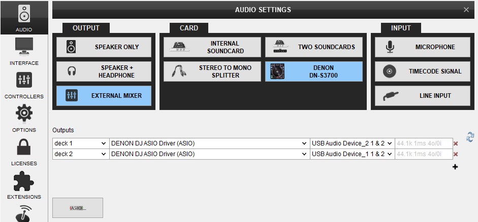

Ok so here is an update.
I stopped messing with it for a while. Still not much help from tech support. I bought into the monthly subscription as one of them told me I needed to have a sub in order for him to help me... and then it was time to clock out. Wow.
So I'm not so sure if that mapping even works because I can't even get past the loading phase. When VDJ loads it resets all my settings... So this is where I am:

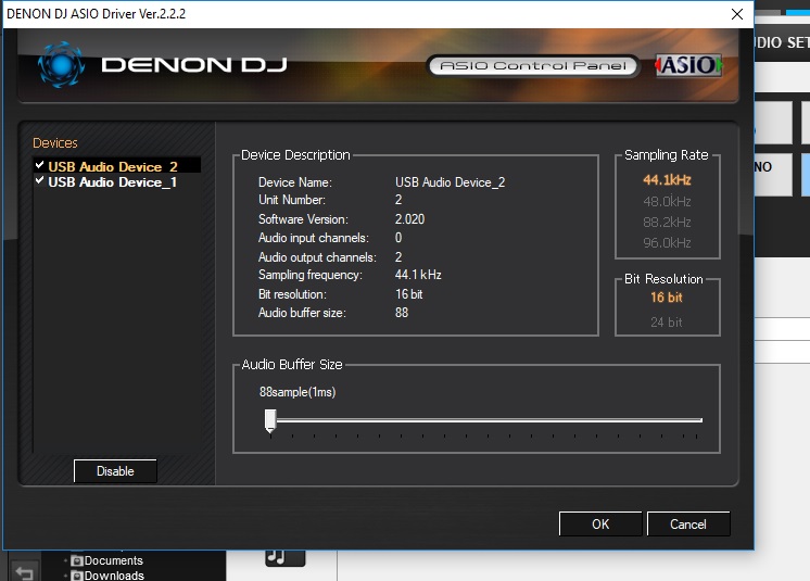

Internally, inside the turntable's settings, the left deck is set to "Unit Number 1" and right deck is set to "Unit Number 2"
However, when I load the DenonDJ Asio settings, the first deck listed it "Unit #2" and second is "Unit #1"
This may or may not indicate placement but just showing me what is available... I'm not sure. See the screenshot, It is simply listing what media players are connected.
I have 2 options for Asio... "Denon DJ Asio" and "DN-S3700 (WASAPI)" (and... "2-DN-S3700 (WASAPI)" is another option.) So far I've been using the "Denon DJ Asio".
Using an external mixer, my outputs are just my decks... So I would think Deck 1 would be "USB Audio Device_1 1 & 2"... but when I use that and load a track on the LEFT table in VDJ, the sound goes to the right turntable and right channel. So when I switch the tables in the controller list (Deck 1 and 2), my left turntable spins as it does in the program but sound comes out the Right channel of my mixer.
So I basically go back and forth with all of this. Keep in mind... Any time I change the settings under the "Audio" tab, the program restarts and it puts me back at the factory default "controller" setting with the mapping set to "Factory Default" and the "Deck" selected to "Automatic"
I can't save my settings!!! I've tried clicking the floppy drive icon on the Audio tab. I type in a name, example "3700" and it's there until I click apply then it goes away.
However after messing with it for some time... I can get it to work. Left deck on VDJ playing to the left physical turntable with sound coming out the "left" (or first) channel of the mixer. However, tonight, I've been at it well over an hour and can't get it to work.
I'm just gonna leave this here. It's already becoming a long read and I just want help. The perc of having my entire music collection at my fingertips is going to be worth it. I hope.

HOLY F#&$
I finally got it working... with the following setup:
So, basically everything is backward yet it works. under audio, Deck 1 is set to "deck 2" and under controllers/mapping I switched Deck 1 and Deck 2 and it works. It's double backwords so I'd guess that the exact opposite would work but it doesn't?
So how can I save this setting? So that when it opens again I don't have to re-do all this? Because I swear I've had it set this exact way before and it DIDNT work so maybe there is something else going on.
when I click the floppy nothing happens!

There have been some crashes logged that appear to be in the denon asio driver.
You could try to use WASAPI instead.
In the audio tab configure as follows:
deck 1 - DN-S3700 (WASAPI) with channels 1/2
deck 2 - 2-DN-S3700 (WASAPI) also with channels 1/2
You can swap the first and second one if the sound of the left deck is coming from the right output and the other way around.
