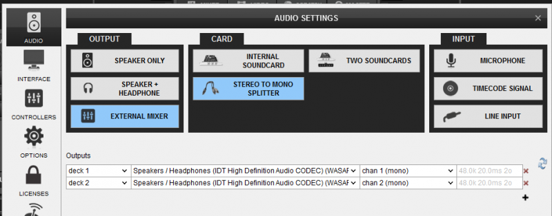

Then I would probably just test it with a splitter cable and get both channels from your regular PC output
It has to be a splitter cable that's meant for it, so that it put's one channel out as mono out to either output connector, and make it so that if you attach a stereo cable to those, you get sound in both left and right channel
Like this one:
https://www.amazon.com/Griffin-DJ-Cable-Headphone-Splitter/dp/B00AE7D2HM
And then setup VDJ like this:
Remember that you still need a VDJ license to run like this for longer periods of time
