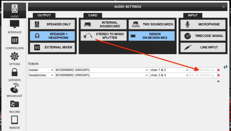

I submitted a ticket and support got back to me with a solution that worked:
"The audio tab is showing a 30 ms latency which is way to big of a buffer and probably the reason. In SETTINGS->OPTIONS TAB search for latency and see if it's set to "automatic". This is the default setting and should lock onto what what the driver is currently set to. You can try changing it to 512 which should give you about 11ms. After you change it please close the settings window then restart VDJ and open the AUDIO tab and see if the new latency is being used. see attached screen capture. "
Posted Fri 20 Oct 17 @ 8:38 pm
In case you are using the WASAPI drivers (as in the picture), you need to change exclusiveAudioAccess to Yes if you want to manually change the latency.
