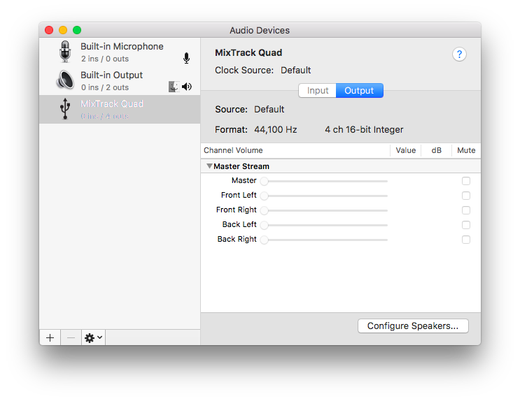

Make sure the Mixtrack sound card is also detected in the Audio Midi Setup of Mac (Applications->Utilities) and is not the selected/default audio device for Mac OSX.

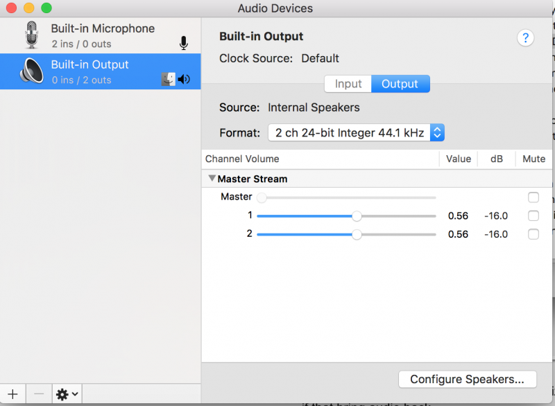

Looks like it's the sound card.......this is what I have under the audio setup....sooooooooo what next?

Dead Mixtrack Quad then, I guess. How old is it? Under warranty?
Contact Numark and see what they say. Also contact the retailer.
