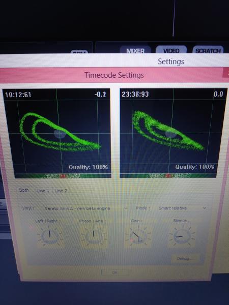

Fired up V8, was getting a very wobbly sound and it sounded like crap. Took a pic of my settings:

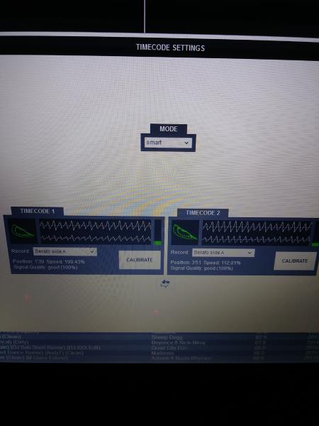

Noticed I was only getting half circles in the config. Also noticed if I tapped on my mixer or turntables, it would cause the quality to jump all over.
Fired up V7, and same thing...half circles with very bad wobbly sound....
So what could have happened? The quality shows 100% on both V8 and V7, I didn't change any other settings, my ASIO latency is set at 6ms (changed it a to a few different things with the same issues), hit the calibrate a few times in V8, checked to make sure everything was good with cables, even changed time code and needles to different ones all with the same result. So what in the world can I do to solve this?

You can see from the circles and the wave that the input signal is very bad. It's supposed to look like smooth sine waves, but it is looking almost like saw-tooth.
The 100% quality indicates that it's still able to decode the position, but as you see from the pitch value this is not stable because of it.
It doesn't look like a latency problem, and since you already replaced needle and vinyl my guess would be cables (or connectors), or otherwise your sound card.
Posted Sat 08 Jul 17 @ 7:12 am

Thanks Adion! I checked all my connections and everything seemed to be ok. It's probably the internal sound card in the mixer crapping out. I'll try a different mixer and see if anything is different.
Posted Mon 10 Jul 17 @ 11:47 am
If the same sound card is used from Windows (as default recording/playback device), perhaps you could try to select a different one (e.g. your computer's built-in sound card) from Windows Control Panel->Sound
